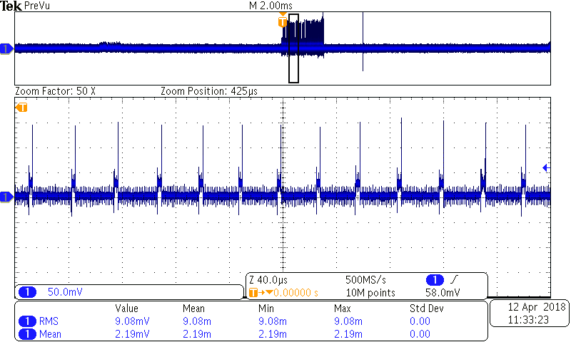

  • This is a capture across a 100Ohm resistor into the VS pin. Looks like ~20uA which would explain the issue.
    The question is, if I am using 210uA in the calculations shown earlier, how do I correct this?
    Mick
  • Hello Mick,
    I noticed two things:
    • The NPA=5.17 and NPS=16.5 in the EVM how is your ratio different.
    • The voltage drop across the diode is different from the one in the EVM have you changed the diode?
    I would suggest to put the original values in the divider and check for 5Vout regulation to make sure if other components have been damaged.
    Sonal
  • Sonal,
    The NPA and NPS values were taken off of this datasheet https://www.mouser.com/datasheet/2/445/750313739-1222373.pdf . I have not changed the transformer. I have swapped out the secondary side diode to https://www.mouser.com/ds/2/258/mcc_ss12-ss110hsma-1179975.pdf (SS110). We have confirmed that when reverting back to the original values of 100k and 30k that the EVM is in regulation with this diode. I will however revert back to the original diode to test.
    Mick

  • Sonal,
    Thanks for the help!
    Going back to the original diode on the EVM allows for regulation at 6.5V. Based on the datasheet, it call out for a reverse voltage with at least 30% margin (100V was used) and a current rating 2-5 times rated maximum draw (1A was used for a 500mA max load). Are there other considerations that we need to account for when selecting the secondary diode?
    Mick
  • I would also make sure that it is a fast recovery diode.
    Good to know that your problem is solved.
    Sonal
