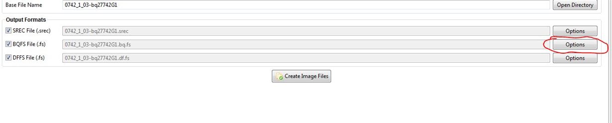

  • Hi Satoshi,
    Does your bqstudio have the options button as shown below when trying to extract your gmfs.? if it doesn't then it means it is the tool doesn't have that option included for the bq27425.
    The entire byte including the the commands should be less than 32. If bqstudio doesn't have that functionality, then  you would want to try doing it manually.
    thanks
