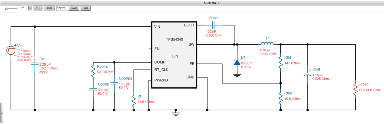

I am using the TPS54340 to provide +12V, 3A with a Vin of 14-18V.
I used WEBDesigner and built the 5 PCBs using the design.  They marginally work when starting up with load of 1-3A.
The layout is text book.
The symptom appears to be output skipping - I added ULVO to not start until I am above 14.5V - that help get the plots provided.

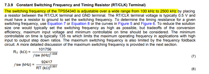

The datasheet calculations suggest a max Freq of 330 kHz but the WEBDesigner provided 84.5k for ~ 1MHz.
I suspect it is frequency related but don't know why WEDDesigner can be so misleading.  FYI if you put the design example in the data sheet into WEBDesigner it violates the rules also.

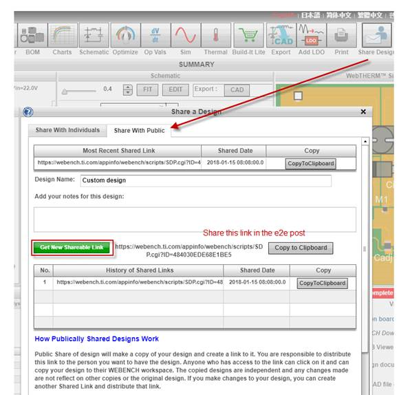

    Could you please let us know that whether you are using the same board schematic & BOM components that as of  WEBENCH schematic?
    Please share the design link with us using 'Share Design' option on WEBENCH as shown below.
    Kindly note that the maximum frequency of the device is 2.5MHz, Please refer to the below points in the datasheet  as shown below.

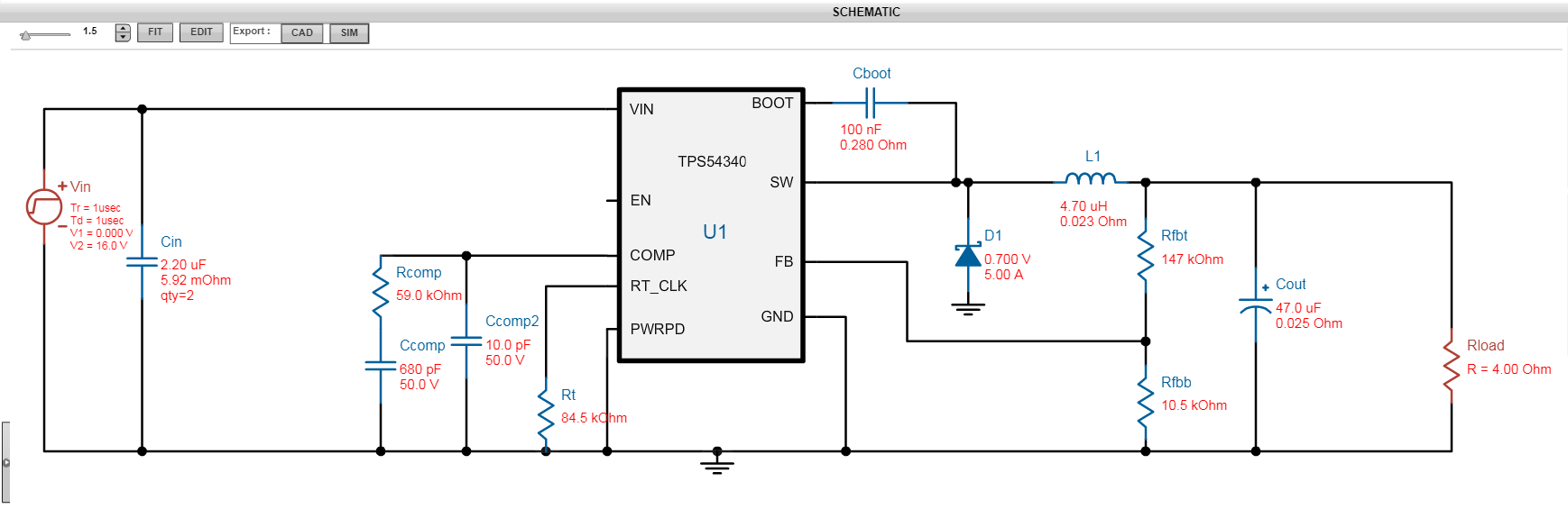

  • Hi Praveen,
    I tried a few different input options (Vmin/Vmax a few volts difference) since the original schematic and build.
    Don't seem to be able to reproduce the exact component list as the original for some reason.
    The link is:
    Rt is slightly higher than the original and compensation is slightly different.
    I re-read section 7.3.9 when the design provided by WEBENCH did not work .  WEBENCH  appears to violates that section - a design optimized for size that violates the component design rules is not a design - agreed?

    also the requirement for regulation requires the max frequency to be step down from 1 to 8.
  • this issue is not resolved
    please explain equation 10 in the data sheet with respect to the max frequency allowed from equation 9.
    WebDesign sets the frequency to ~1.1MHz while equation 10 states under digital selection to maintain current regulation it needs to be ~ 300kHz.
