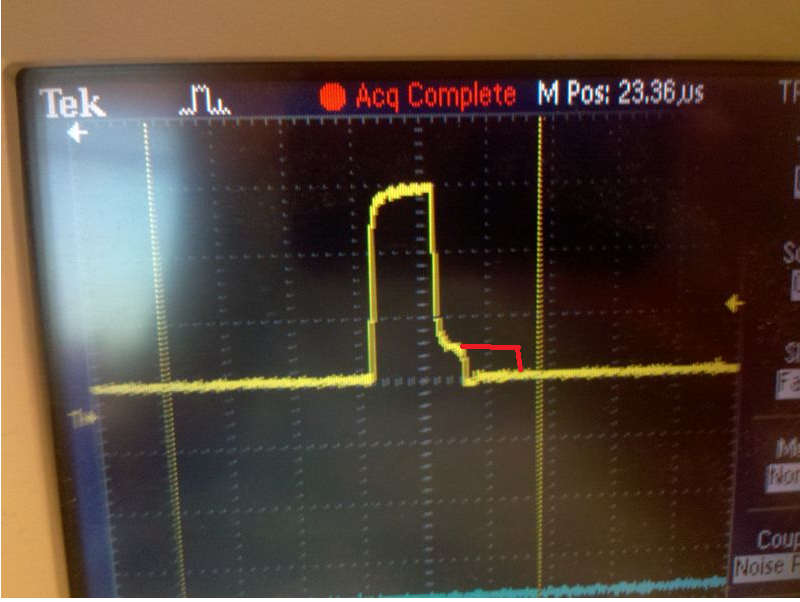

What I can see from scoping the SCL/SDA is the SCL is pulled low by the UcD90120A just (0.2us) after the 9th rising edge of the access (in the middle of the ACK/NACK) regardless of the address sent on the I2C bus.
I can see that the SCL is first pulled low by the UcD90120A and then 50ns later by the I2C controller and held low for 1.25us before the I2C controller continues generating 400kHz clock pulses.

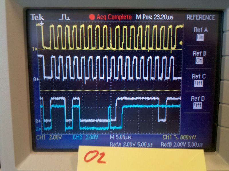

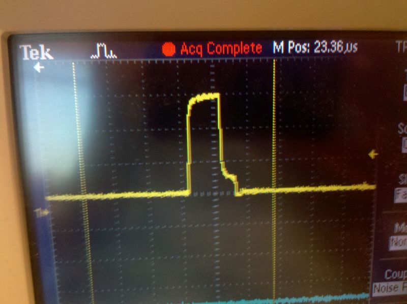

Scope shot: (Yellow: SCL, Blue: SDA, White: Reference from working board)

  • Thanks for the fast reply.
    Yes, the master supports clock stretching.
    - If you look at the white traces, it is from a good board where the UcD90120A ends up clock stretching. Also note that the ACK is present.
    - The yellow and blue traces is from the same access on a board that fails. Also note that there is a short NACK-like pulse.
    No, there are not any other devices on the I2C bus, neither slaves nor masters.
    Yes, it is the very small pulse before the 9th clock that actually is the 9th clock, but being pulled low by the UcD90120A immediately after the rising edge.

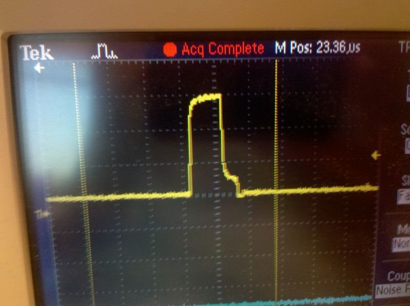

    I tried reducing the pull-up on the SCK to better see the difference between the master (lower impedance) and the UcD90120A (slightly higher impedance) driving low.
    And here is a zoom of the pulse (250ns div):
    Here it is clear (if the image was less shaken) that the clock is pulled up (by the pull-up) for 250ns, then driven low for 50-100ns (by the UCD), then driven low by both (probably) for 20-50ns and at last driven low by only the master.
    The thing I find very strange is that one board went from working to failing when I downloaded a new configuration via JTAG - I have done this tens of times before without problem. All boards have the same configuration.
    Søren M.
  • Soren
    Thanks for the descriptions.
    I could not think about how UCD pull-low the SCL when master is activly driving it. for a 400KHz speed, the clock pulse shall stay high at about 1.25us. based on the waveform, the SCL was pull-low completed around 700us. if it is UCD who pull low the SCL, i would expect the SCL shall look more like below since i2c host still driving the clock even if UCD try to pull low the SCL.
    but based on the real captured waveform, i2c host also stops driving the clock early.
    Is this same waveform repeable? can the TI USB-TO-GPIO Dongle talk to the sane UCD when i2c host is isolated? are theire any hardware or i2c host software chagnes among those boards?

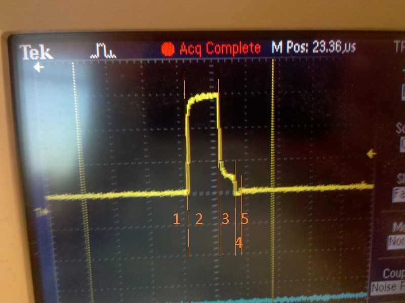

  • I cannot see either how the UCD can drive the SCL low in this way without violating the I2C specs.
    SCL is pulled high by a 100 Ohm resistor for this scope shot (normally this is 1k) to be able to distinguish between the master and the UCD driving SCL low (there is nothing driving SCL high - only the pull-up).
    With 1k pull-up the regions 3, 4 and 5 look to be at the same voltage (<0.1V) , but the width of the high pulse is the same.
    1: SCL driven low by master (for 1.25us as expected - only last 1us visible on scope)
    2: SCL pulled high by pull-up
    3: SCL driven low by UCD <- this happening is what I find very strange
    4: SCL driven low by both UCD and master
    5: SCL driven low by master (for 1.25us - only first 1us visible on scope)
    I guess the master drives SCL low when it senses it low and expect it to be high as a part of its clock stretching support.
