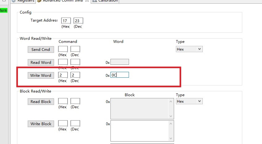

In advanced comm SMB, MAXERROR value change to 2 is unsuccessful.Register address OC.
BQ4050 can modify FCC value, but can't modify MAXERROR value.Is that right?
Maxerror can't be written unless you are sealed. Was your gauge sealed?
All operations in unseal,we can chage FCC value,only not chage MAXERROR value.
I know this,but BQ3060 and SN8765 maxerror is writable.BQ4050 is application in the low-end market,many customers are not to learning,so they will change this value directly.
