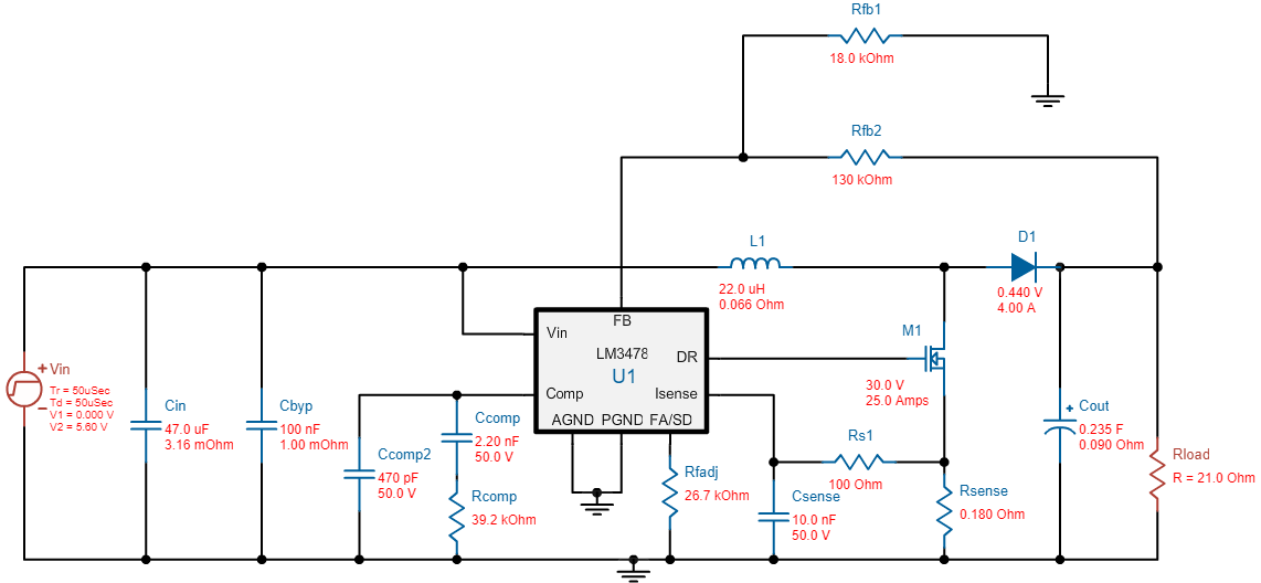

My customer has a question.
Q.
When starting up with the following circuit,
Inrush current flows greatly,
While repeating shutdown and restart by overcurrent limitation,
The output starts up.
Is there a problem with this usage?
If there is a problem,
Is there a way to reduce inrush current?
(Capacitance of the output capacitor can not be changed.)
