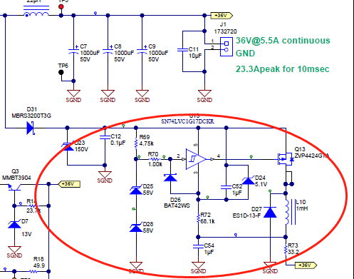

Hi Team,
    We want to use PMP10215 for our product, and we find a question about this circuit, pls. help to explain the function of the below circuit red highlight.

  • Hello aggil,
    This is an auxiliary buck switcher configured with discrete parts and its input is from the main 36V 200W output.
    I will contact the circuit designer and find out why this is a feature of the PMP10215

  • Hello aggil,
    I received this reply from the designer:
    The circuit in the red line is actually a Buck converter.
    When the voltage on C12 is higher than V(D25)+V(D28), which means we have a spike on anode of D31, we have a current through R69. If this current is sufficient to drive the Schmidt trigger input (pin 2 of SN74LVC….), then we have a Ton over Q13. During this small Ton (which is synchronous with switching waveform of the main converter, but has duty cycle dependent on the amount of energy is contained in the spike), the Buck converter, defined by Q13, L10 and D27, will inject the energy during Ton into Vout (36V).
    This way the energy in the spike is recovered cycle-by-cycle and not wasted in a snubber resistor. It’s actually an “active snubber”.
    John
