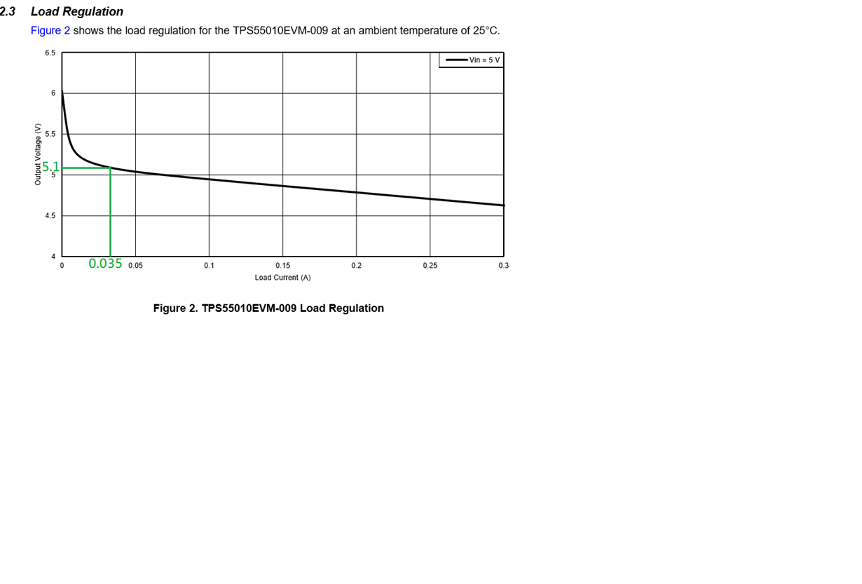

Hi Anthony,
We test add a 3K ohm resistor (See attached schematic of R658)on the output as we discussed before to keep the voltage about 5.5V.
But output voltage still keep in 6.5V with 3K ohm resistor when no load on the output.
The output will reduce to 5V when add a 33 ohm resistor.
But 33 ohm draw too much power and TPS55010.pdfthat is not a solution.
Do you have any idea about how to reduce the voltage ?
Thanks!
Chin
Hi John,
The voltage change from 6.7 volt to 6.4 volt when add 200 ohm on the output load.
As I mentioned , the output voltage will change from 6.7 volt to 5 volt (what we want) if I add 33 ohm on the output load.
But 33 ohm consume power very much and that is not a solution.
Sincerely,
Chin
Hi John,
Yes, I also have the ciurve picture you provided.
But my question is why I add 200 ohm of resistor on the output load and the measure voltage is 6.4V?
The load current is 0.0325A(6.5V/200Ω) when add 200Ω on the output load and according to the curve you provided, the voltage should be 5.1V rather than 6.4V of my measurement.
Chin
