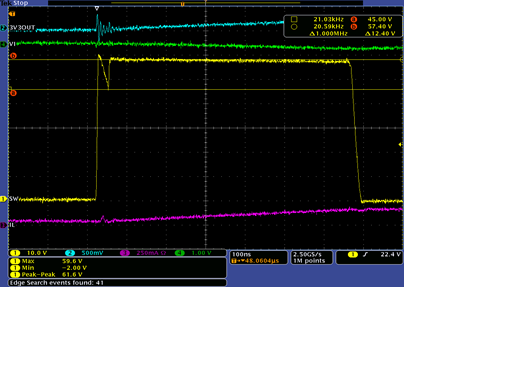

LM5008A: voltage drop on switching node
Part Number: LM5008A
all,
  A question about LM5008A switching waveform, there is a voltage drop on switching node on LM5008A EVM if Vin is 54V. If Vin is 36V, the waveform looks good, no voltage drop. Why is there a drop here?
CH1 (yellow): LM5008A switching node
CH2 (Blue): Vout
CH3 (pink): inductor current
CH4 (Green): input voltage
