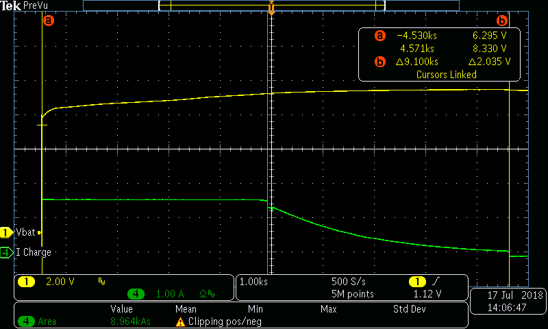

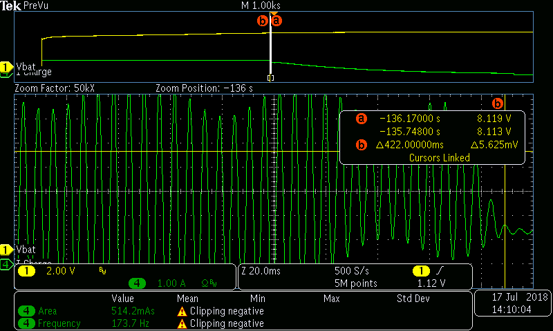

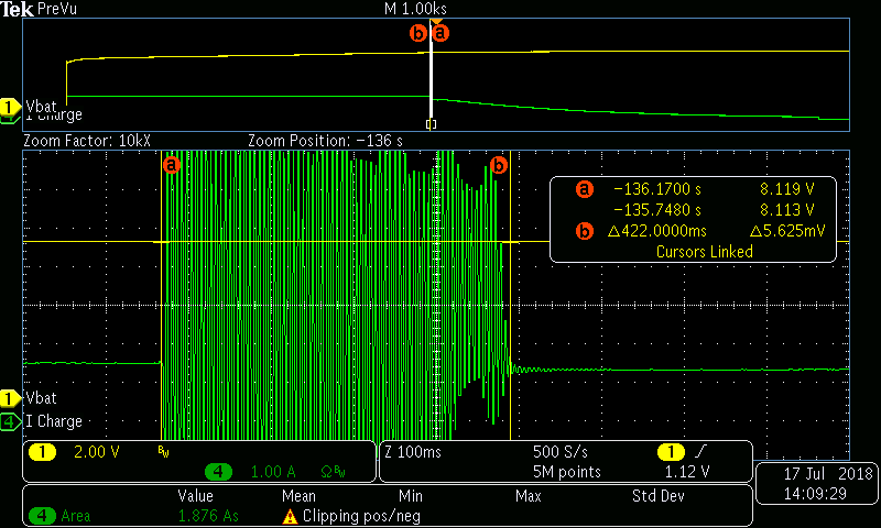

Hi Team,
I test the charger Find Oscillation when the Charger Change mode From Constant Current
to Constant Voltage for 422mSec >7A p-p and 174Hz
I do Changes in the EVM:
R15=0.02
R18=32.4k
R32=22.1k
R9=37.4K
C23=33nF
Can possible to eliminate this Oscillation
See attached pic
