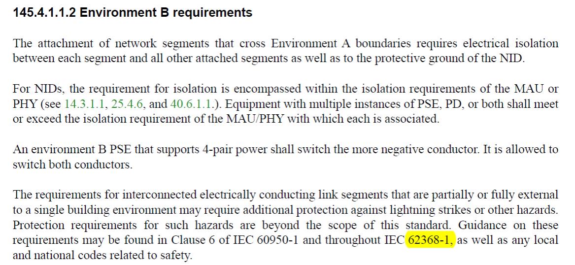

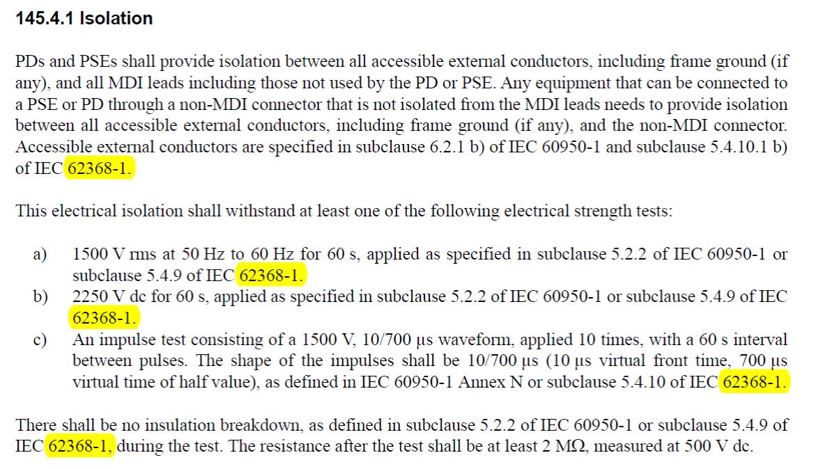

  • Hi Mick,
    See the following snippets from the IEEE 802.3bt standard regarding IEC 62368-1:

    1. Does 802.3bt meet the IEC 62368-1 safety standard for external circuits not connect to AC mains? How does IEC 62368-1 apply to ethernet equipment?
    Answer: I probably overemphasised IEEE 802.3bt. My question was “does your recommended designs comply with IEC 62368-1 (Edition 3 now)”. The reason for asking this is that, being a hazard-based standard, the user is expected to interpret the expected hazards and provide by design appropriate and justifiable safeguards to prevent injury or damage. IEC 62368-1 doesn’t recognise IEEE 802.3bt, the IEEE standard isn’t a normative or bibliography item.
    There are two types of ports in IEC 62368-1
    mains: AC or DC power distribution system (external to the equipment) that supplies operating power to the equipment and is PS3 (PS3 means >100 W continuous so IEEE 802.3bt does not qualify)
    NOTE 1 to entry: Mains include public or private utilities and, unless otherwise specified in this document, equivalent sources such as motor-driven generators and uninterruptible power supplies.
    external circuit: electrical circuit that is external to the equipment and is not mains.
    Thus, the Ethernet port should be evaluated for external circuit hazards and TI’s field experience knowledge is needed here in defining hazard levels and events.
    2. Should we use the 1.5kV 10us/700us transient test defined by ITU-T, or 2.4kV 1.2us/50us defined by IEEE 802.3?
    Answer: Although for long distance external cables the ITU-T SG 5 does use 1.5 kV, 10/700, but for Ethernet type ports the ITU-T uses 2.5 kV (basic) and 6 kV (enhanced) charge voltages on a 1.2/50-8/20 surge generator. The 6 kV setting comes from equipment manufacturer’s analysis of field ONT equipment failures in severe customer premises situations. The 2.5 kV generator charge voltage setting outputs an open-circuit voltage of about 2.4 kV and so agrees with the IEEE 802.3 2.4 kV.
    3. For the IEEE 802.3 standard, how did you determine 1.5kV rms/2250Vdc for impulse testing?
    This is the crazy thing that IEC 62368-1 has retained the AC and DC prescriptive test source approach of IEC 60950-1. This is unfortunate as it leads people not skilled in insulation testing cherry pick parts of IEC 62368-1 and come up with the wrong answer as in IEEE 802.3bt.
    In IEC 62368-1 clause 5.4.9 Electric strength test really defines the test levels you are talking about for mains ports (this is why IEEE 802.3bt is wrong to call out a mains port as an Ethernet port). For 230 V rms mains and basic insulation the highest result from the three required evaluation methods is 2.5 kV (AC 1.77 kV rms and DC 2.5 kV). For routine test these values can be reduced to DC 2.25 kV and AC 1.6 kV, which are not far away from the IEC 60950-1 values of DC 2.25 kV and AC 1.5 kV rms. Now these levels are mainly set by peak transient voltage and for surge testing the appropriate peak voltage would be 2.5 kV (type test) and 2.25 kV (routine test).
    Other things to consider is that Ethernet port has functional insulation NOT safety insulation and the main safety hazard event is AC mains power cross.
