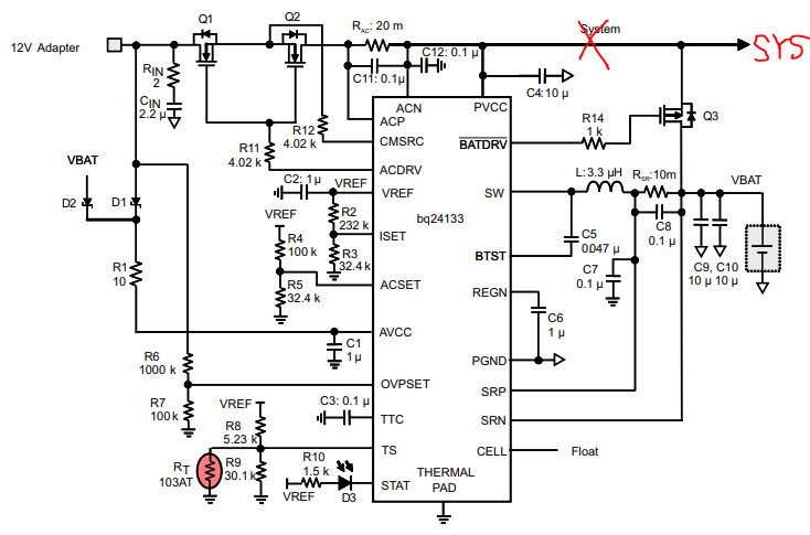

Greetings!  We are experiencing a fault condition on this charger that we are hoping you can help us resolve.
Our setup:  we are using the BQ24133 charger chip with a 2 cell Lipo battery with capacity of either 6 Ah or 10 Ah.  It has a built in 10 kOhm thermister.  We laid out our schematic exactly as the example circuits in the datasheet.  We used all the example circuit values.  So our charge chip values should be: VIset= 403 mV (should result in 1.01 A charge current limit), VACSet = 0.82V to 1V (should result in 2.5 A input current limit).  Our power supply is a 12 V AC adapter.  We do have the STAT pin tied to one of our system microcontrollers as well as to the stat LED.
Our problem:  we will have the 12 V adapter and the battery plugged in and charging (stat LED is solid red), then when we turn on the power to the load, the charger goes into fault (stat LED blinks).   If we unplug the 12 V adapter and plug it back in, it usually clears the fault (sometimes it takes more than one unplug/plug attempt to clear the fault).   The problem is almost exactly the behavior as defined in section 9.3.19 of the datasheet.
With our system fully booted, we are pulling minimum 2 A and up to 30 A into our load.
Things we’ve tried:
1. We verified all the conditions of section 9.3.9 in the datasheet for enabling the charging.  They are all within the required limits before and after switching.  We did not verify them during switching, but if they are stable after switching we feel like that should be sufficient to enable charge again.
2. Increasing the current limit on ACSet by replacing R4 (on the TI datasheet, nominal value 100K) with a new resistor valued 10.4K, leaving everything else as-is, so the new current limit should be 6.25 A. This didn’t solve our problem.

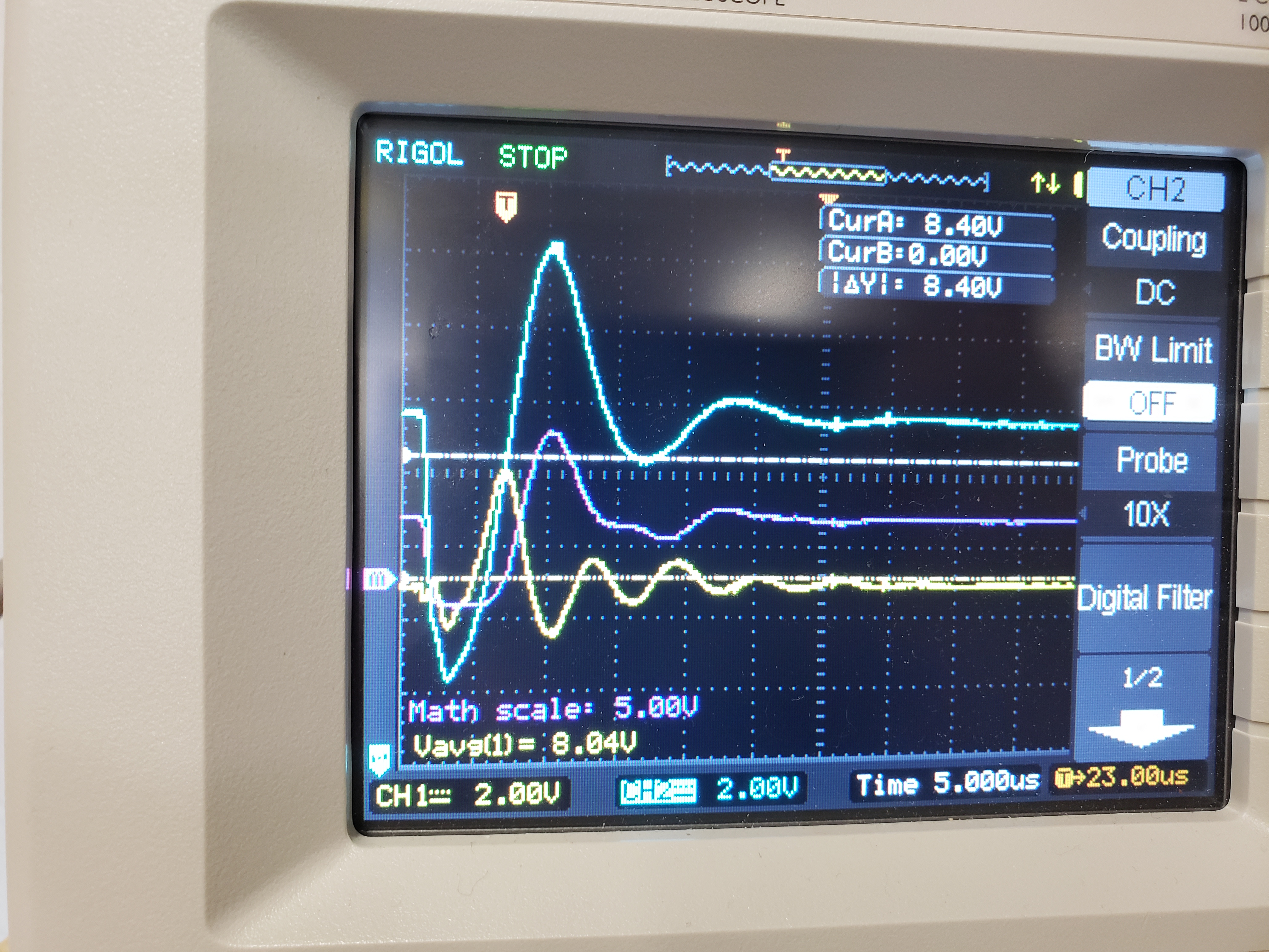

3. Thinking about section 9.3.19, we measured the voltage across both ACFET and BATFET.  The waveforms that were obtained upon powering up the system are shown in the image below.
CH1 (yellow) is VBAT.  CH2 (blue) is the 12 V adapter.  Purple is the MATH channel doing a difference between them.
With such a large voltage sag, we suspected inrush current trying to charge capacitors.  Going off the last line in section 9.3.10, we added capacitance between the Source and Gate of Q1, Q2, and Q3 to try to slow the inrush current, but after adding 114uF of capacitance, we were unable to prevent the fault.  Then we tried slowing down the inrush by placing a 56 Ω, 1 W resistor in line with the AC power in, we were able to consistently run our system without the board going into fault (only running the system at 2 A).
We are looking for inrush protection circuits with the right level of inrush protection that also work at 30 A.  However we want to verify that the problem isn't in the circuit of our BQ24133.   We are on the fence about where the problem actually lies, so we are hoping to get some input from this forum.
Please ask any questions, and we'll try to answer them expeditiously!  Thanks!

    For section 9.3.19, you will need to look a the cycle by cycle current limit. The inrush current might exceeded the the current limit and triggers the short circuit protection. It will be helpful if you are able to probe the input inrush current.
  • "9.3.19 MOSFET Short Circuit and Inductor Short Circuit Protection
    The IC has a short circuit protection feature. Its cycle-by-cycle current monitoring feature is achieved through monitoring the voltage drop across Rdson of the MOSFETs. The charger will be latched off, but the ACFET keep on to power the system. The only way to reset the charger from latch-off status is remove adapter then plug adapter in again. Meanwhile, STAT is blinking to report the fault condition."

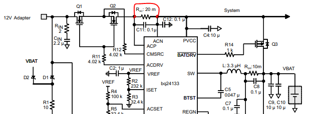

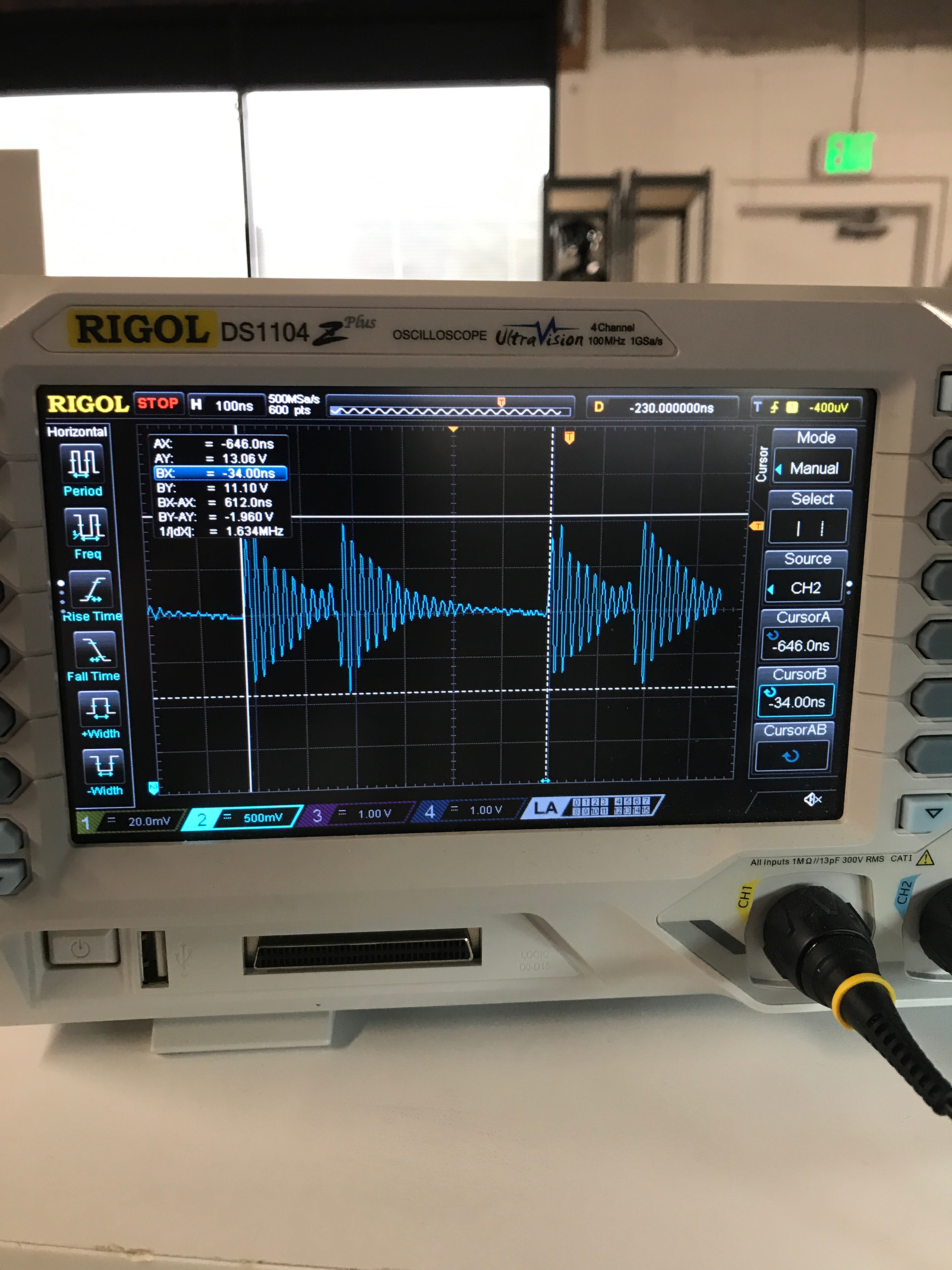

    2) When I measured the inrush current using the current sense resistor Rac, I had some puzzling results. I put the oscilloscope probes on either side of this resistor, and took the difference between the sides using the oscilloscope's math function. When I did this, I had a 200mv to 1V spike every time I turned on our system. Since our Rac is 0.02 ohms, that means that there would theoretically be a maximum of 50 A running through that resistor when we turned on the switch. I don't think this is correct, but do you have any idea what this might mean? I have attached a video of my setup (sorry it's sideway, and every time I move the switch, the oscilloscope screen changes.
    3) I measured the current through the inductor off the charge chip, and saw that if the system was off, leaving just the battery charging, the current through the inductor was 0.499A. I then saw that when I turned on the system and it wasn't in fault, it had a max value of 0.369 A through the inductor. Finally, if our system was in charge fault, the current through the inductor would immediately drop to 0. What do you make of this data?

    Unfortunately, I cannot open the the video file you uploaded so I cannot check the setup. However, from the scope capture of Steve's post, the inrush spikes are in us range. The deglitch time for the faults are typically in ms range. Thus, I think inrush current is not the cause of the latch off.

    - The Rac is to sense the input current and the input current control loop can limit the input current by adjusting the charging current, targeting Psys + Pchg = < Pin.  The system is to draw tens of Ampere current from adaptor, conflicting with the Rac limit design 2.5A. Rac does not perform the function and seems redundant in the current design.
    - There is severe LC resonant  due to the high system current, the cable inductance, capacitance or bad adaptor dynamic response. To verify this, one test can be done to isolate the issue. Remove Q3 BATFET and R11, Short  Q1, Q2 and Rac (create a direct power path from adaptor and system. I would expect to the waveform of  12V would have the same ringing as the blue trace.

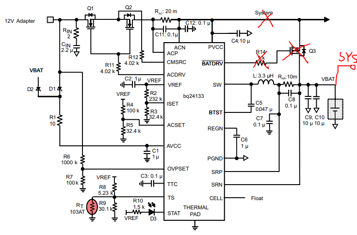

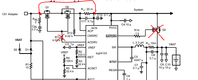

    We did the modifications that you asked for us to do to bypass the charge chip and see if the ringing was the AC adapter or the charge chip. The results were a bit puzzling. After modifying the board as directed, we found that this is the waveform when the system is switched off and charging the 7.4V battery.
    And this is the waveform when the system is switched on.
    It's important to note that the ringing seen in this screenshot is not the same as in the waveform screenshot shown in the very first post, and it has a completely different timescale (100 ns versus 5 microseconds.) Additionally, the very first screenshot shows the behavior when the system is switched on, while when the system was switched on in these experiments, it had no such behavior.
    Finally, I'm a little unclear about what I'm trying to look for by doing a "crossing check with Adaptor + customer board + system vs power supply + EVM + system." Am I supposed to measure the VSystem waveform, or am I just supposed to observe the STAT pin light to see if the system is going in to fault or not?

  • Cate,
    It looks like to me that the adaptor was plugged in when you started the system. The issue here is that the system current will be from adaptor (12V) first if the adaptor is plugged in. The battery won't help until the adaptor voltage is pull down to 7.2V. I think this will trigger some protection functions of the adaptor before the battery provides the current.
    For the waveform, it is not clear about the measurement point. Since you have the EVM working properly, cross check is to compare and help to find the difference.
    The operation of the system should be with adaptor unplugged.
