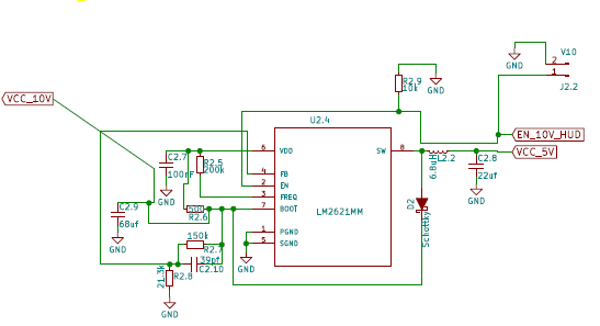

I want to convert the 3.7v- 5v input to 10 v output. I prepare a circuit but did not get 10v . Output voltage is 4.88v instead of 10v.

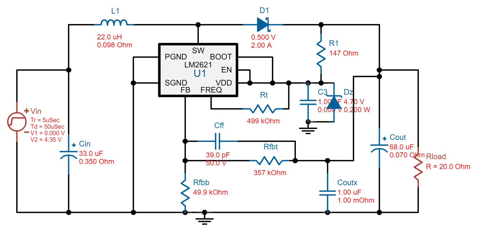

1. VDD pin has a 5V maximum voltage limit. So you cannot connect the vo to VDD directly. You could use a 4.9V zener diode to generate a voltage for VDD,EN and BOOT.
2. What's the load current? Are you just simulating in PC or doing a test on bench? If it is a test result, please provide the key waveforms, such as SW, inductor current, Vin.

Our requirement is to generate 10v (700mA) from input source 1 cell lithium battery. We tested our schematic on PCB an voltage stable at 4.88v. We requires 1.8v logic signal for enable chip from microprocessor side.
I request you to please suggest the right schematic for our specification.
