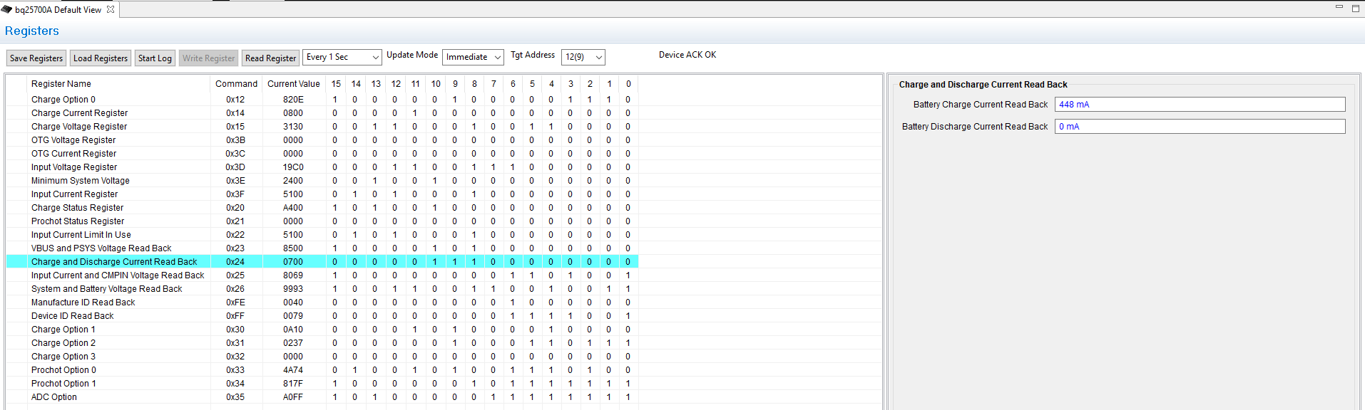

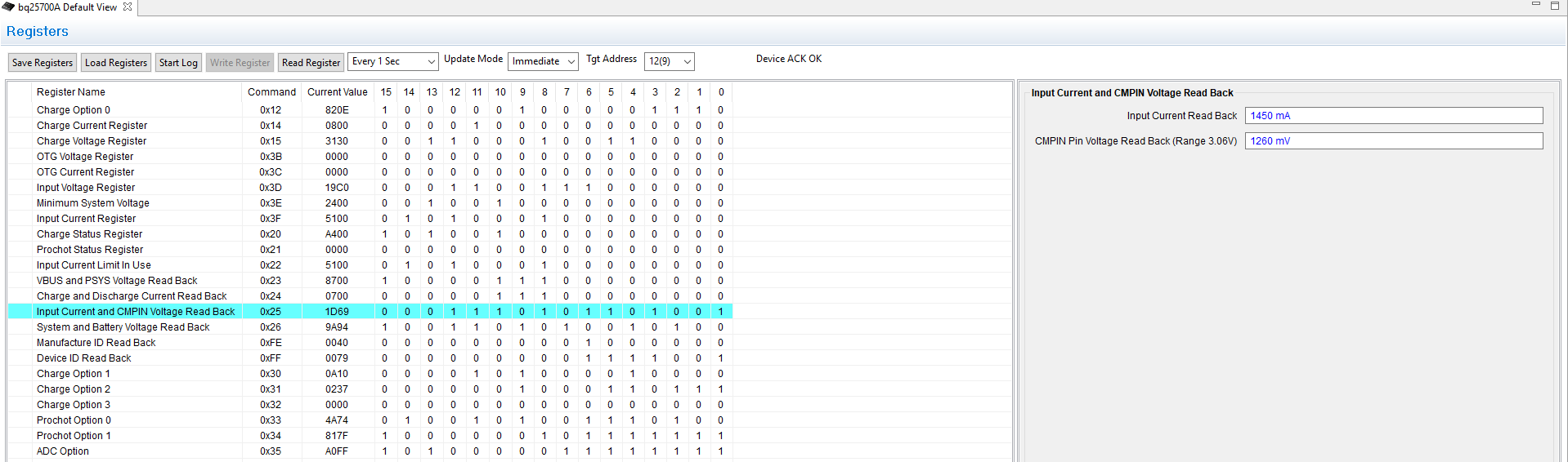

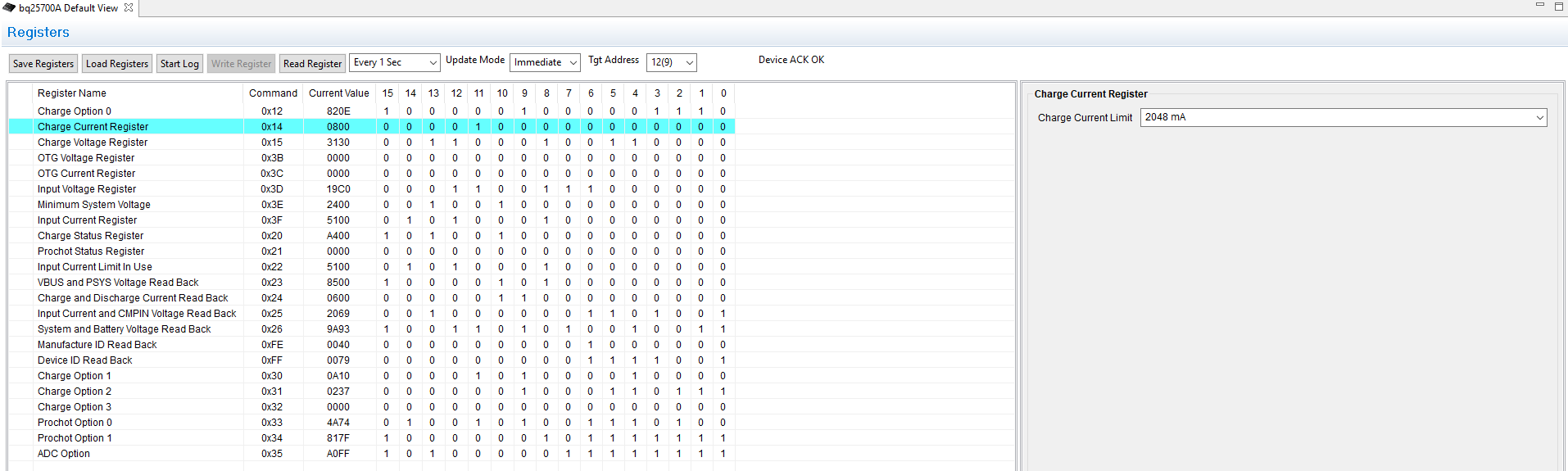

The parameters we used shown in Figures 5-7. The Figures 8-12 show the data from Battery Management Studio v1.3.80 and indication of an external power source.

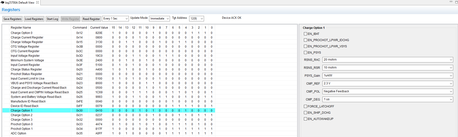

3)    If the resistor R27 is set to 20 mΩ instead of 10 mΩ, input current is not adjusted correctly. The board consumes twice less current than is set in the 0x3F register. Setting the resistor parameter in the 0x30 register does not result. This problem is illustrated in Figures 8-9. With installing a resistor of 10 mΩ problems are not observed.
4)    Charge and input currents from ADC in Battery Management Studio are not true. With using 20 mΩ input resistor the input current shows correctly, but when using 10 mΩ this does not happen, but the charging current is still incorrect. This problem is shown in Figures 10-12. At the same time, the charger correctly regulates the current (with 10 mΩ resistors), but the data in the Battery Management Studio is not shown correctly.
Please comment on this situation and give appropriate recommendations regarding the using the chip.

Figure 5Registers in BMS
Figure 6 – Input current register and real current
Figure 7 – Charge current register and input current
Figure 8 – On the board RSNS_RAC is 20 mΩ, in BMS RSNS_RAC is 10 mΩ
Figure 9 – On the board and in BMS RSNS_RAC is 20 mΩ
Figure 10 – Wrong ADC data
Figure 11 – Charge current from ADC
Figure 12 – Input current from ADC

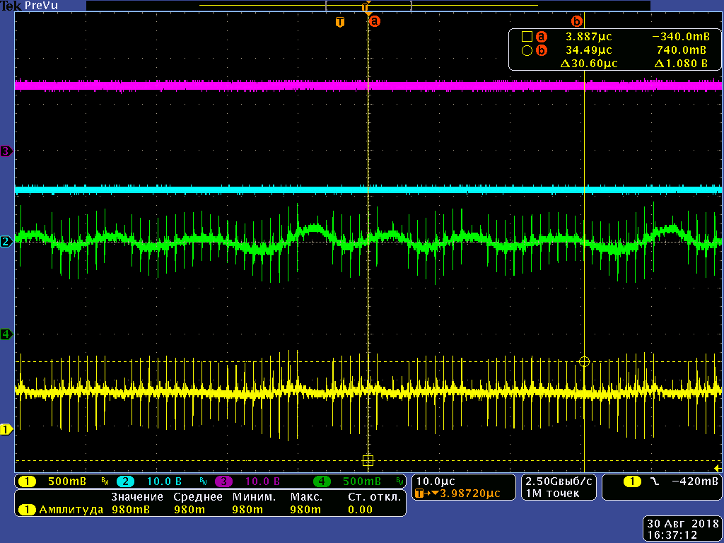

    Can you provide a waveform of the SYS voltage. BAT voltage, BAT current, and either VBUS input voltage or input current when in both buck and boost mode.
    I want to see if your design is unstable.
    Joel H
    Charge Current 2A, Input Current 3.25A. Input Voltage: boost mode – 12 V; buck mode – 18V.
    IADPT(4 green) VSYS (3 purple) IBAT (1 yellow) VBUS (2 blue)
    10 mOhm RAC, Boost:
    10 mOhm RAC, Buck:
    20 mOhm RAC, Boost:
    20 mOhm RAC, Buck
    I am reviewing all of your data to investigate this issue further.
    Joel H
  • The waveform shows that the charger did not switching. The Vsys is from the adaptor but from the battery voltage. There is ~500mA loading on the system. It is really tough to debugging the board remotely. We would suggest compare the operation with a BQ25700AEVM, which is a four-layer board, with most of the two inner layers as ground for noise reduction and thermal improvement. The two-layer board is noise sensitive due to no shielding layer and also has challenges for thermal management due to limited copper area. The EVM guideline is here www.ti.com/.../slua808.pdf
