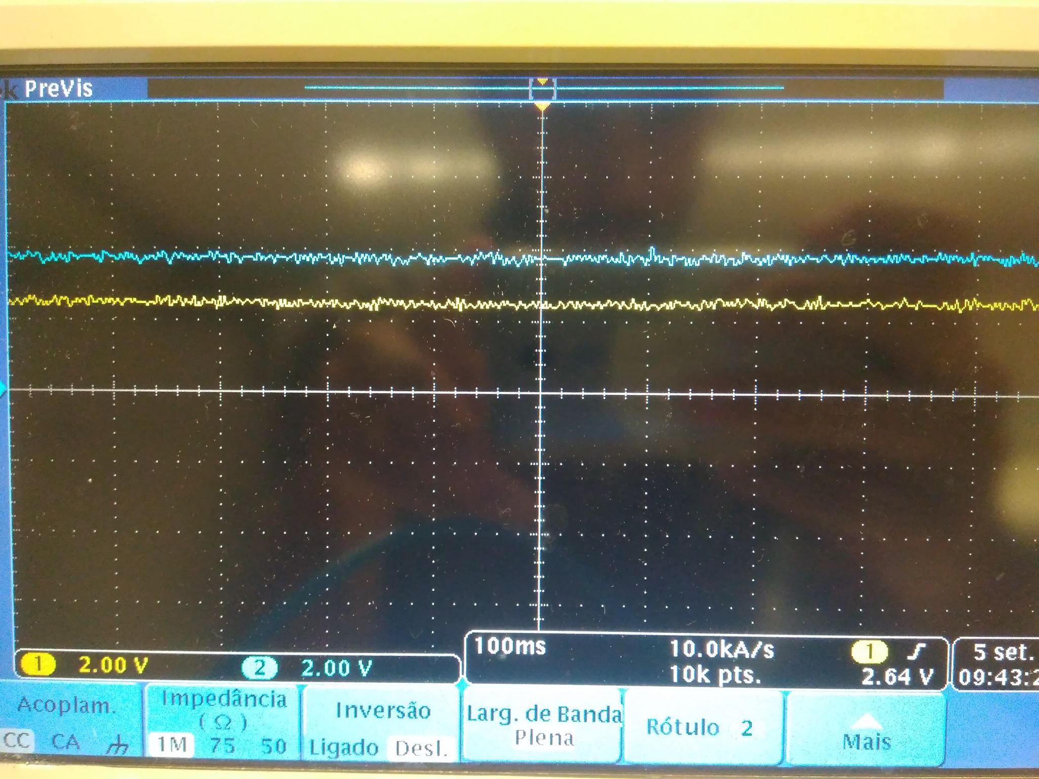

  • Hi Brigitte,
    - voltage from the FB pin to the GND pin for different input voltages?
    The result is:
    Vin = 3.1 -> V FB = 0.178V
    Vin = 3.6 -> V FB = 0.527V
    Vin = 4V -> V FB = 0.672V
    input voltage and output voltage with the GND reference connected to the GND pin of the IC.
    Blue-  Vin
    Yellow - Vout
    thank you,
    BR
  • Hello Roberto,
    The feedback voltage has to be 0.8V.
    In your board, the feedback voltage is not even close to where it should be. Please check the switch nodes L1 and L2.
    If these are not switching, please check the output voltage, when you connect EN to GND.
    If you still observe voltage there after you discharge the output cap, the IC is most probable damaged. Please replace the IC and check again.
    Brigitte

    I think that found my mistake, in my PCB the PIN 2 isnt connected to ground, its foating.
    only can be this.
    I will say the result to you when correct this
