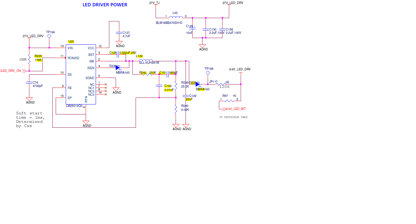

Hello All,
I am using this IC for an output of 9.6V with 0.1% resistor divider for setting the output to the mentioned voltage.
1st time run gave a result of 9.5V which was acceptable. But from the 2nd run it started giving an output of 6~6.2V having no change been done to the circuit.
Properly simulated in WEBBENCH, the only change is inductor  value for which the webbench showed a value of 100uH in place of which i am using 390uH inductor. Although the webench showed no change in the output value after changing the value in the schematic from 100 to 390uH.
There-fore the issue came up after the 1st time run.
Please help.
