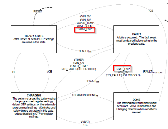

2. The state diagram on pg 32 implies Battery Overvoltage causes a fault when the IC is in Ready state or Done state.  However there is no mention of Battery overvoltage elsewhere in the documentation nor is this fault described in the Faults/Fault Mask register on pg 37.  Please clarify what this fault is, what are the limits on BAT_OVP, and if it is reported as a fault.
pg. 32
  • Hi Vic,
    Safety timer bit: The full 9hour can be selected by using bits 10 for the safety timer bits.
    BATOVP: Sorry about that, BAT_OVP is an internal signal and shouldn't see a mention on the datasheet. The device will terminate charging when the charging process is complete. I will update the datasheet to reflect this change. The device only has BAT_OCP which can be read on the faults register.

  • Vic,
    The electrical spec table indicates only the min/ max on the timer by design the smaller end is coming for precharge which is 0.1x fast charge timer. The device only has the bits you have identified.
    What is the exact value you are looking for? There is a 30 min option.
