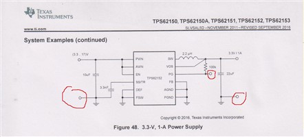

Where should the 3 connections i circle in red connect to?
  • Hi Chris,
    These are connections back to your system. You supply Vin (and GND) and you get Vout (and GND). Also, PG is reported back to the system.
    We also have the power module TPS82150 for a simpler design and the new TPS62147/8 for a higher efficiency and more featured design.
