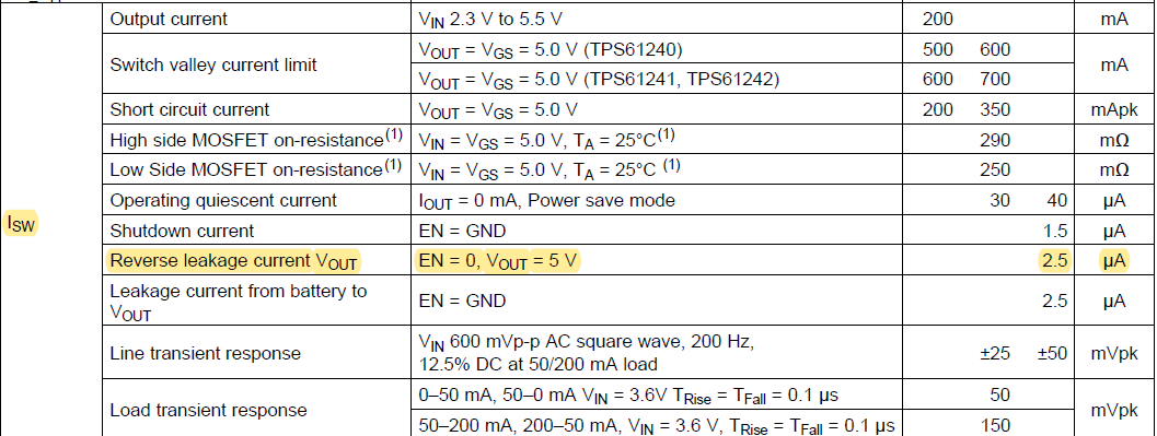

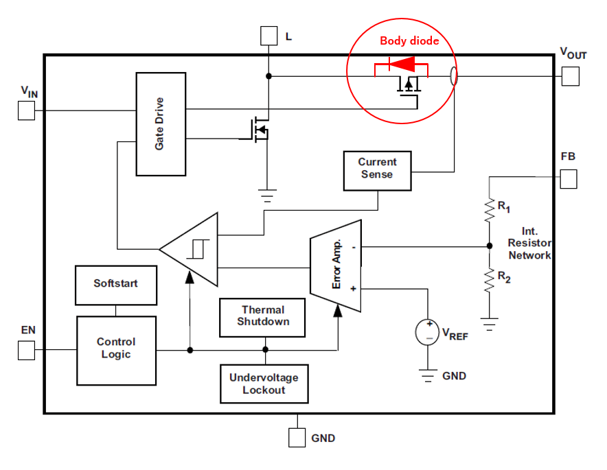

Hi Team,
IF VOUT > IN (for example, VOUT=5V, VIN=Open), does the reverse current flow?
I found “Reverse leakage current VOUT” in the datasheet so I understand that the reverse current doesn’t flow.
Is my understanding correct?
