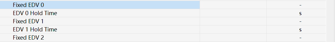

For CEDV gauge, such as BQ78350, we need to set Fixed EDV0, Fixed EDV1,Fixed EDV2 before performing a learning cycle then upload data to GPCCEDV tool.
However, I'm not sure how to set these 3 paremeters , below are 2 methods I heared, could you kindly help to suggest which one is the right choice? Is there another better way to setting Fixed EDVx ? Thanks a lot.
1) Discharge from full to empty with 0.2C, 0.5C, 1C, 5A in room temperature, and calculate the EDVs with 7%, 3%, 0%  of RSOC for each discharge rate, then avarage the result in 4 different discharge rate for EVD0.EDV1,EDV2; Perform 3 cells with above cycle, and do the avarage to decide the final  Fixed EDV0,  Fixed EDV1, Fixed EDV2
2) Discharge from full to empty with actual load with typical user case in actual temperature the pack will be put , and calculate the EDV2,1,0 with 7%, 3%, 0%  of RSOC ; Perform 3 cells with above cycle, and do the avarage to decide the final  Fixed EDV0,  Fixed EDV1, Fixed EDV2

    If you are planning to use the GPCCEDV tool and use compensated EDV values, it is not important to identify fixed EDV values first. The GPCCEDV tool needs discharge logs at constant loads and the only data that it uses is: time elapsed, voltage, current, and temperature. You can use the BQ78350 to collect this data for your battery, but it is not required - the important thing is to capture how the battery discharge curve behaves with different loads and temperatures.
    When you capture this data with the BQ78350, you want to make sure there are no protection faults triggered causing the FETs to open and make sure the battery is fully charged and let it rest for 2 hours before staring the discharge to let it reach equilibrium. For accurate temperature measurement, make sure the thermistor is attached to the surface of the cell.
    Here are some notes below on using fixed EDV vs. CEDV (more accurate):
