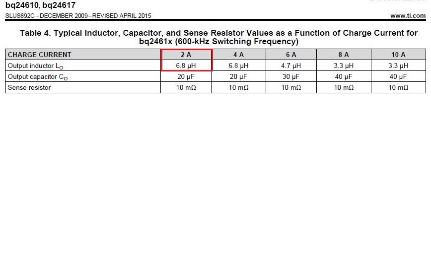

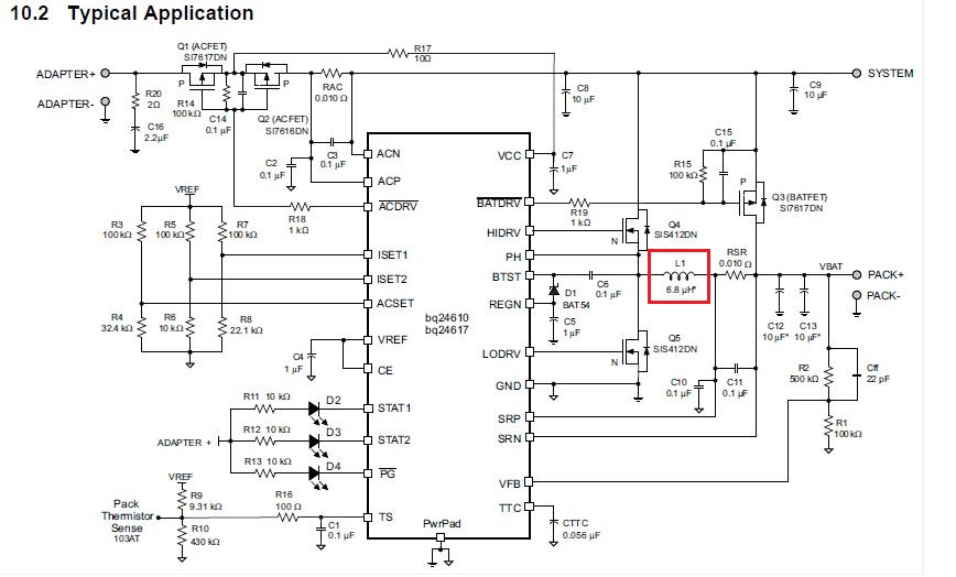

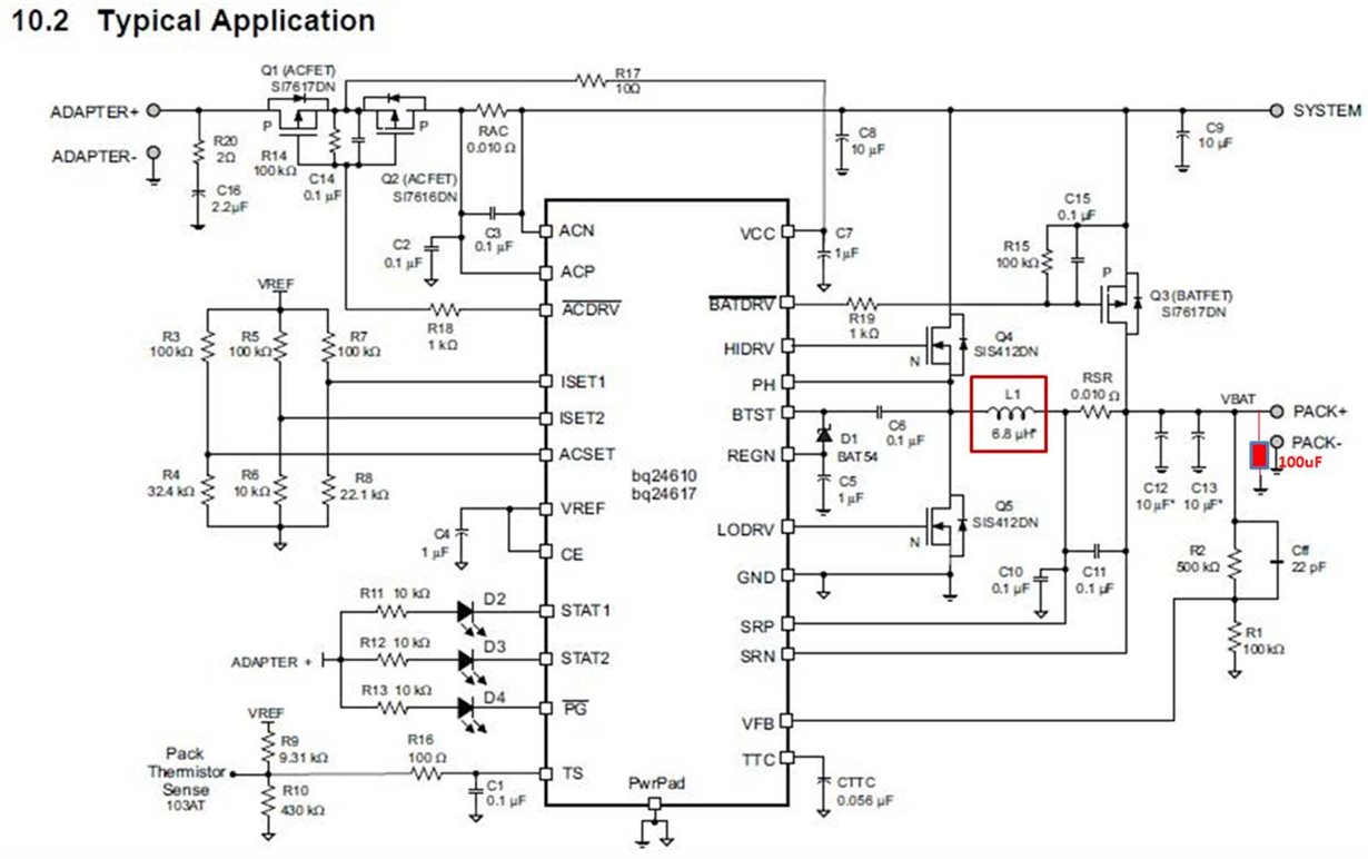

Dear experts, I use the bq24610 to charge 4-series Li-iron battery. The external DC adapter will select 19V or 24V product. The charging current will set 800mA or 1.5A. The PACK+ voltage will set 16.8V. From TI datasheet, It suggest to use 6.8uH inductor(If charging currrent is 2A). If I change inductor from 6.8uH to 10uH, is it suitable? Does it will cause any defect or fault on system operation? Because I want to increase the inductor value to see the result of EMI radiation. Maybe it wil have improvement to reduce the system EMI. On the other hand, I will reduce external DC Adapter voltage from 24V to 19V to see the EMI field intensity(I already add the snubber and gate resistor, but EMI test is still fail.). Regards.
