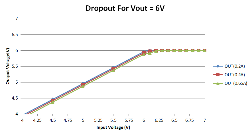

LMZ21700: Dropout voltage of LMZ21700 with Vout = 6V
Part Number: LMZ21700
I am using the LMZ21700 with an output at 6V/50mA.
In these conditions, what is the minimum input voltage to ensure proper operations?
Looking to figure 8 and 9 in the datasheet (doc number SNVS872C) does not help, because Vout is 5V and 3V3 respectively.
