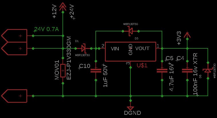

TLV760: POWER UP ISSUE.
Part Number: TLV760
Support needed for the following circuit:
powering up with a 24V wall mount power supply and powering off and repeating on off on off few times …..the TLV76033 (U$1) will burn… also releasing 24V on it's output destroying all the remaining electronic.
How to go on with this product design ? what's wrong ?
thank you.
Fabio
