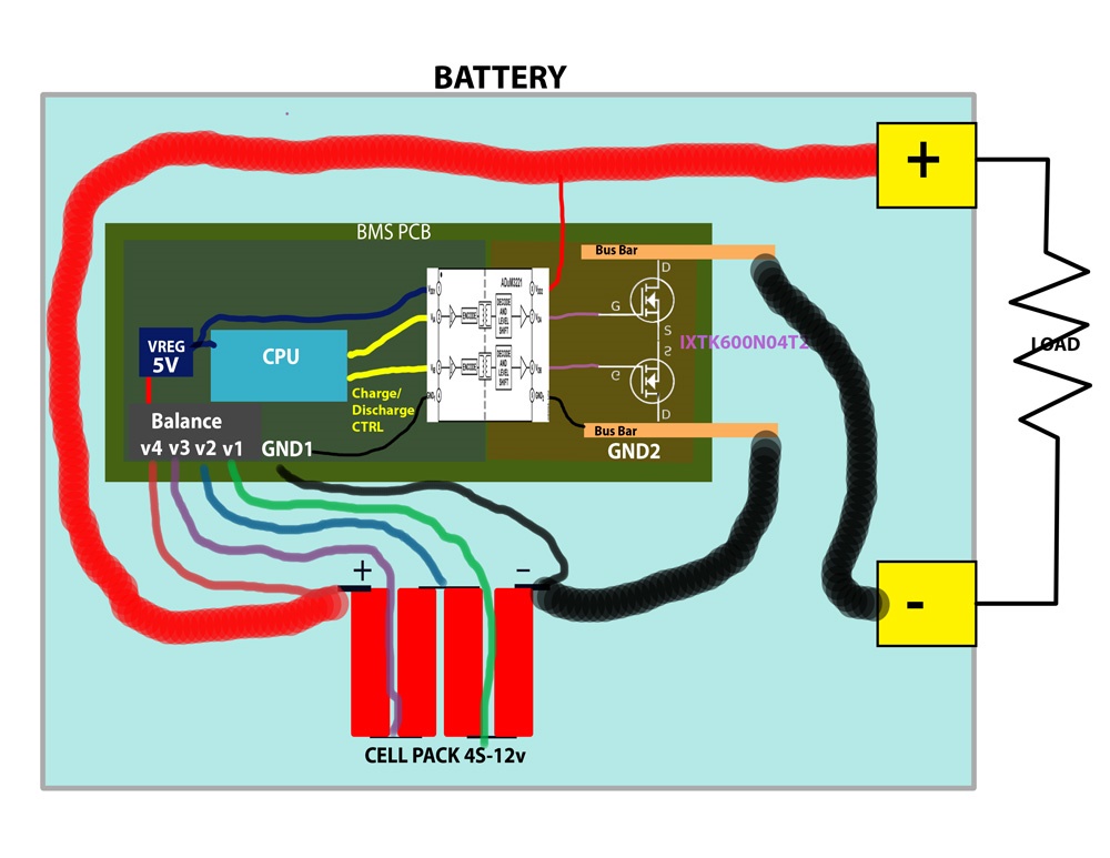

I need to control lower mosfet with a gate driver that is isolated, but design below does not allow for isolated grounds.  I could possible use an isolated power supply for gate drivers or maybe your LM5110 would create a negative voltage for mosfet drive?

    LM5110 and LM5112 are great choices for its negative output voltage capability.
    You may use LM5110-3 (dual inverting/non-inverting channels) and just use the inverting channel to drive the lower FET.
    The thread below further discusses how to generate negative bias for the driver.
    e2e.ti.com/.../713670
