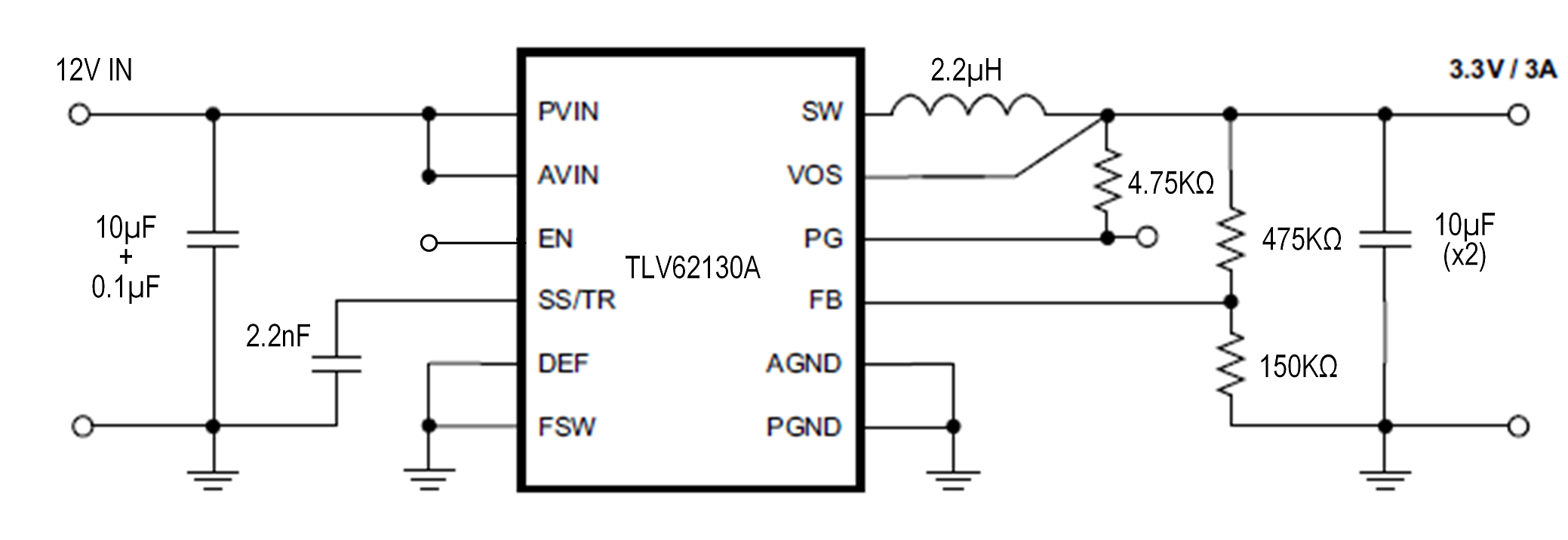

I am trying to bring-up a TLV62130 12V to 3.3V regulator circuit, but it seems to restart continuously.  The scope shot below shows the ENABLE, VOUT/VOS and SS/TR signals.  I assume that the SS/TR signal going low means that a failure condition has occurred.  From the datasheet, I see that one of these conditions occur: (1) a shutdown (EN=GND), (2) an undervoltage lockout or (3) a thermal shutdown.  The condition causes an internal resistor to pull the SS/TR pin down.  Returning from those states causes a new startup sequence as set by the SS/TR connection.  Is this what I am seeing here?
(1) As can be seen, the enable signal stays high.  (2) While VIN is not shown, it isn't going undervoltage - it is around 12V.  (3) The time frame is too short to have a thermal shutdown, right?
What might be causing this shutdown to occur?  Are there other conditions not mentioned in the datasheet that would cause a shutdown?
Here is the schematic:
There is a 1KΩ pull-down resistor for the DEF pin, but this isn't shown.
The layout is not optimal.  For instance there isn't a separate trace from the VOUT to the VOS input.  It is all part of the same copper fill.
