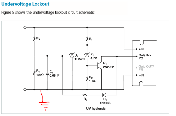

We use the TLV431 in the undervoltage scheme as advised on an application note. The only difference is our 0V is connected to earth.
We are having products returned from customers for failing to power-up. In our diagnosis we have determined that when we replace the TLV431 the power supply unit is restored completely.
Please advise on what could be causing the failures. Failures are reported within 1 to 18 months of deploying product.
Details of the undervoltage scheme are on
http://www.vicorpower.com/documents/application_notes/UV_OV_APPNote.pdf
