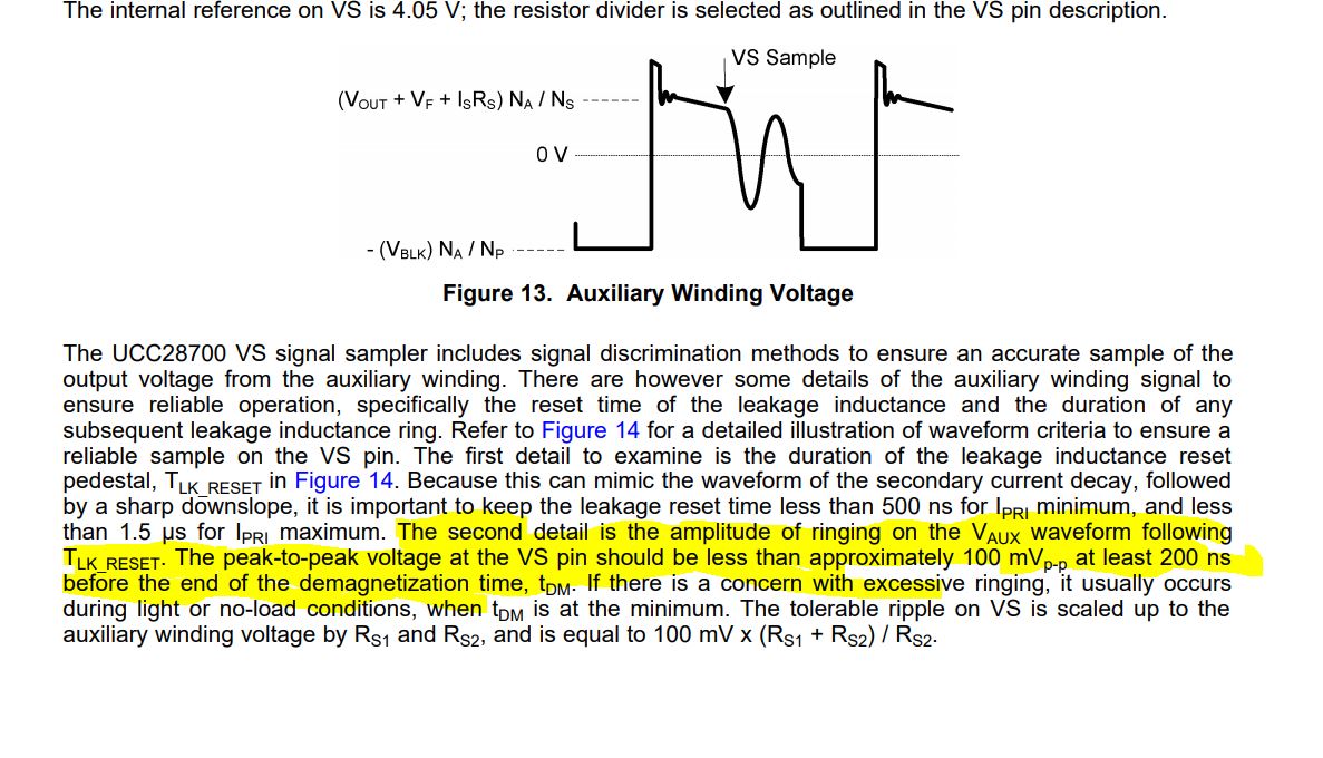

I have problem with leakage induction in my transformer.
 At the moment I added a small C on Rs2. But is this the best solution to solve it?

    I have some experience designing power electronics. I  use the UCC28701 for a 24V->5V supply while using a POE transformer.  So that is a not the intended use. But because "I know what i'm doing" This is a working design but because of design tolerances in the transformer I got some issues.
    The UCC28701 oversimplify the design process in the datasheet. So If  you design it outside it for it intended use. You are on your on. That should not be a problem But I need information how to adjust the voltage control loop So I can stay within the save operation area.
    So If TI is unable the rather generic question how to compensate for leakage in inductance in a opto coupler less design.
    Maybe you can help me with the following question:
    UCC28701 datasheet page 9.  The Vs ripple is needed to generate the timing signals for the the duty cycle.
    - How does the  " control law " block generate this signal?
    - How much delay can I add  allowed before stability becomes an issue?
     EVS
    To answer your second question: you will find this information on page 13 of the UCC28701 datasheet.
    Sonal
  • Sonal,
    Thanks for the information. This also answer my question. Vs sample is at the end of the energy transfer cycle so any transfer delay introduced by leakage induction is already passed.
