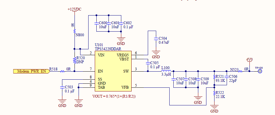

Hi, We are using TPS54229DDAR in our design and here is the schematic:
The parts used are:
  • C503, C602, C505: C1005X7R1H104K050BB
  • C600, C601, C507, C508, C509: GRM188R61C106KAALD
  • C504: GRM155R61H474KE11D
  • R521: RC0402FR-0793K1L
  • R522: RC0402FR-0722K1L
  • C506: GCM1555C1H220JA16D
ISSUE: Problem we are seeing is that there is a very slight humming sound coming around the inductor. Is there any value change that might help us with this issue?
