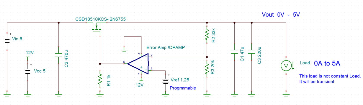

Please help me to understand the linear and saturation region of this Mosfet and the supply conditions. I am trying to form a series regulator using this part. My Vds is 6V, my required output is 4V, 3A, I can drive the Vgs = 0V to 12V using an error amplifier. So that I need this linear region.
What is the charging and discharging current of the Gate? Is there any circuit combination to quick charging and discharging of the gate? Please share the Tina Model for this Mosfet or suggest equivalent part
which Gate driver is suitable for this Mosfet? is it advisable to use Gate driver for this application? Is the gate driver will drive the Mosfet in linear region?

    The part you mentioned is adjustable from vref(1.24V) to 6V, but I need to adjust the output from 0V.
    My application model is working good using CSD18510KCS. My output is not come to stable in quick while add/remove load, it takes some long time so I suspect the charging and discharging current to the gate may insufficient. This is the reason I asked about gate driver.
    Or it is due to any other reason?

    I would need to know more about your circuit implementation to provide better guidance. Are you using an op-amp to drive the gate of the FET? Have you confirmed that the circuit is stable thru modeling or by measuring the loop response (i.e. bode plots)? This FET has relatively high gate charge and input capacitance. The drive circuit will not to be able to source and sink 10's to 100's of mA depending on how fast you need to slew the gate of the FET. For example, if you want to change the gate voltage by 1V in 1us:
    i = C x dV/dt, using Ciss = 8770pF from the datasheet, then the current needs to be i = 8770pF x 1V/1us = 8.8mA. If you want to slew the gate voltage 10x faster, then the current would be 88mA.
    If the drive circuit does not have adequate current capability to slew the gate of the FET, then you can look at adding a totem pole circuit using complimentary bipolar transistors or FETs. Please let me know if this helps or if you have additional questions.

    The exact requirement of design is as follows. We need to produce 0V to 5V and 0A - 5A. (nominal is 3.3V, 5A)
    We are approaching the linear voltage regulator method as follows.
    We sure we can adjust the output voltage by adjusting the Vref of Error amplifier. It works properly with expected resolution.
    But for sudden transient load the output voltage is not being stable. currently we are using CSD18510KCS as pass transistor and LT2057 as Error amplifier.
    By your previous answer and some theoretical study, we looking for a high output op-amp as Error amplifier preferred from TI product. By your suggestion we would use OPA277. We also think to use either LM224 or LM7171 from TI
    We also looking to use any compensation circuit at Voltage divider (Vfb) side and at gate of the MOSFET by referring the video lecture of TI (training.ti.com/linear-regulator-fundamentals-nmos)

    Can you post the Ti-tina file so we can simulate the circuit?
    It will likely need some compensation for stability and your 12V node is programmed to 5V in the image.
    What is the minimum load current? I ask because the regulator correction might overshoot a little (and it needs to drain back to desired voltage)
