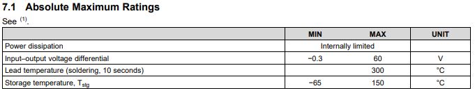

Hi team,
Does the LM317HV also can be used for negative input to negative output?
Thank you!
Hi Zoe,
The minimum input-output voltage differential (Vin - Vout) for the LM317HV is -0.3 V. In a negative input to negative output configuration, the voltage differential would be smaller (more negative) than -0.3 V which would damage the device.
