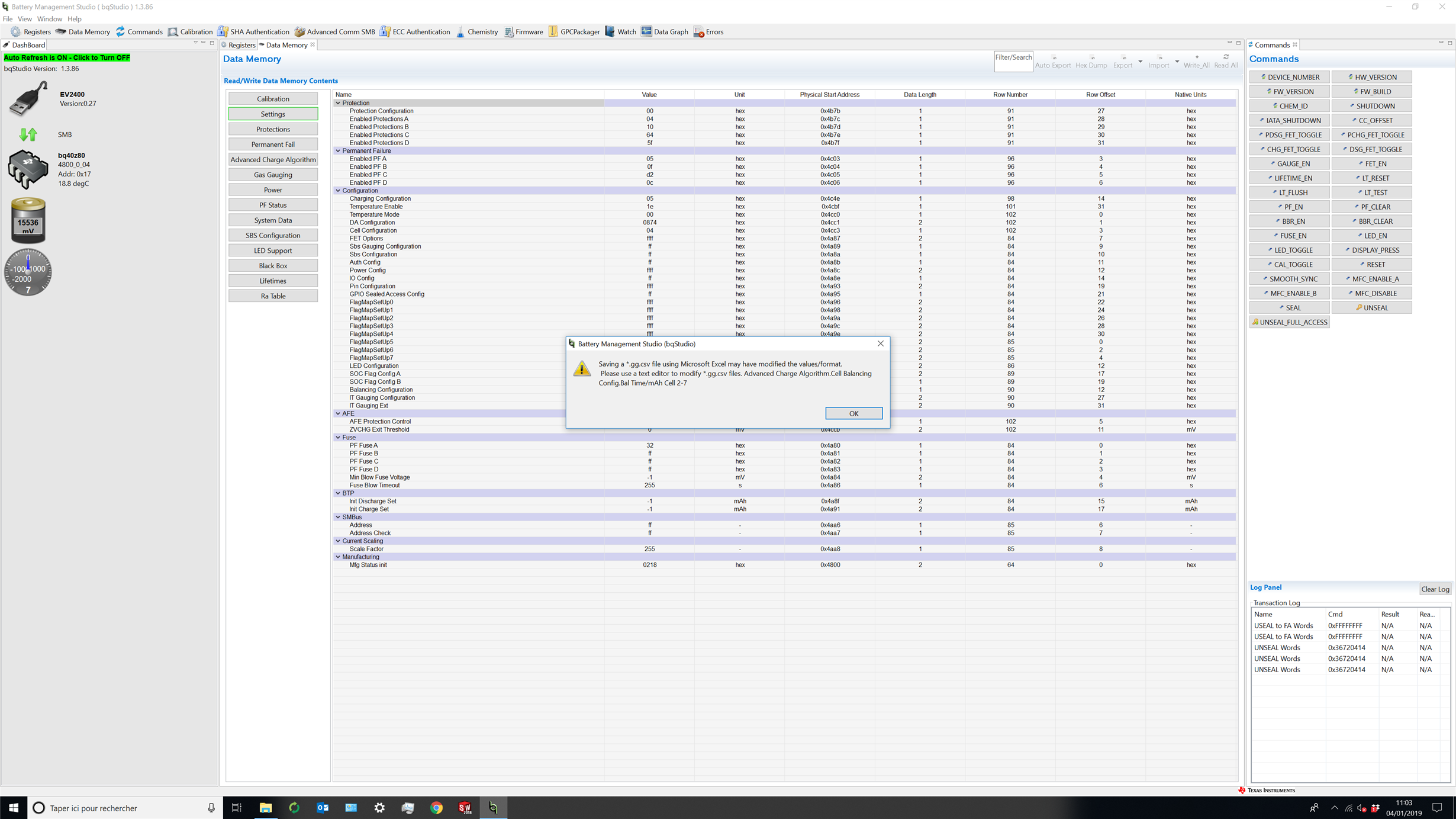

I'm trying to set up a bq40z80 evm before going the custom pcb route for a battery pack, but I can't get bqstudio to stay connected to the board for more than a few seconds. Basically if I press the Wake button, the chip's adress pops up on the left and everything seems to communicate, but then after a while it disconnects.
My configuration is the following:
standard evm board, with d3 and r7 removed as per datasheet
4s 10A battery pack connected to 1n...4p then shorted 4p,5p,6p,7p together.
system presence shorted to PACK -
Did i miss somehting?
