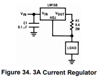

  • Hi Shai,
    The LM150/LM350A/LM350 and LM1086 are some of TI's wide input linear regulators than can be used as constant current regulators without an external MCU. See the figure below for an example circuit. The output current is calculated as follows:
    Iout = Vref / R1 = 1.25 V / R1
    As such, the current regulator shown below can be configured for 1 A by replacing R1 with a 1.2 Ohm, 2 W resistor.
    Keep in mind that these devices will need more headroom (VIN - VOUT) to regulate properly compared to the LT3080. The LM150 dropout voltage is about 1.8 V (typical) at 1 A, and the LM1086 dropout voltage is about 1.1 V (typical) at 1 A.
