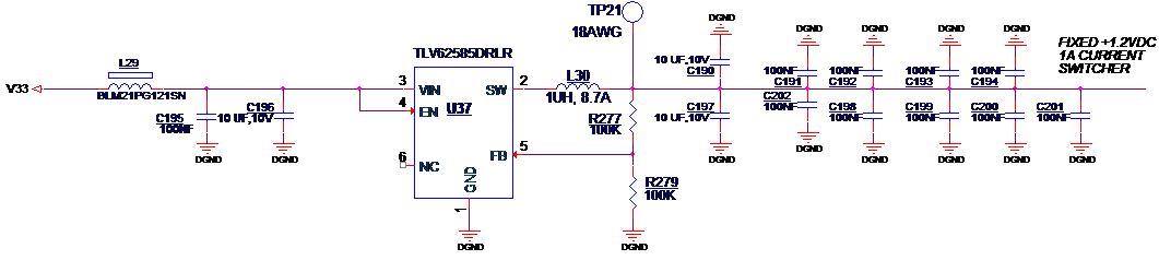

The TLV62585DRLR seems to be stuck in 100% Duty Cycle Low Dropout Operation - we layed the part out exactly like the demo board - what would cause to enter low drop out function?  We need 1.2V output
7.3.2 100% Duty Cycle Low Dropout Operation The device offers a low input-to-output voltage differential by entering 100% duty cycle mode. In this mode, the high-side MOSFET switch is constantly turned on and the low-side MOSFET is switched off. The minimum input voltage to maintain output regulation, depending on the load current and output voltage, is calculated as:
