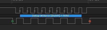

  • I work with Michael Desjardins, the clock is at 100 KHz, but from time to time the device seem to NAK a request to read/write to it. After that the BQ34110 seem to be jam into that state and no more ack any request made to him (no recovery). Even if I break and wait many secondes and start the code again, the next request will do the same and the BQ will NACK everything.
    I can reproduce the behavior faster if I talk to it quickly. I can reproduce the bug even if I don't talk to the other device on the same bus. Since I cannot talk to it anymore, I would need a way to reset it by hardware or to avoid this condition. Anyway to monitor this or strong condition or limitation (not approximation or probably) for that chipset? We cannot run a full day without having this problem and we poll it every seconde. Is there any watchdog or settings we could set to make it recover or reboot if this happen?
  • Here is another example of NAK message:

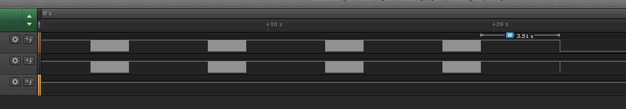

  • The TS pin is pulsing at 20 sec interval (~19.88 sec). Do we have a configuration problem? normal mode is 1 sec from what you said, what mode give 20s pulse? Do you have table ms = what? I'm not the one who did the bqstudio for this, so maybe something is missing there which I'm not aware or our init phase should put the BQ into a different mode.
    I can provide the I2C logic analyzer data acquisition if it can help, it's not top notch, it's a Saleae8 with logic Software and I have to start it manually for around 5 minutes max before memory get too much. Right now I do a loop polling to read the FCC (Full Chare Capacity) every 20 ms to reproduce the bug, it doesn't occur to often so debugging it make it a little hard. Sometime it take a few secondes, some time it take a few hours.  The fater the polling the faster I get a NAK, so the 200 ms, take a few hours to a few days. But from what I can monitor into the MCU, I get NAK.
  • Hi Jerome,
    Those tests were to determine if the device was going into ROM mode or if the device was executing firmware.
    This is good news - the TS pin pulsing at 20 sec just means the device is in sleep mode. The firmware is executing and the device has not gone into ROM mode.

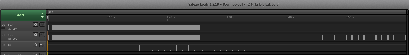

    we did observed a weird behavior from the capture, the TS pulse every 1 sec, a glitch occurred when the bug arrive and the SCL after 6 secondes seem to start pulsing just like the TS pin should! Here is the acquisition we got (see attachment)
    So we can exclude the sleep mode as the source of the I2C non recovery. I known we are polling it too fast, but it seem to reproduce the problem in a decent time (else we have to wait hours, nearly days).
    I'm a little perplex what is happening here during the NAK the TS got a pulse, 6 TS pulse, then the pulse start on the SCL pin?!? Not sure what is going on when this happen, look like an overflow somewhere. Not sure if this is exactly the same bug we see on long usage or if this "normal" when polling too fast.

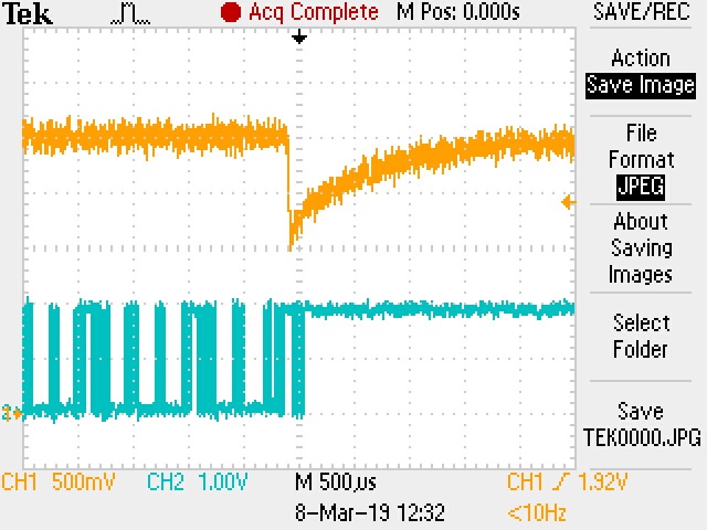

  • We measured the TS signal and SCL on an oscilloscope and we saw that there is a falling edge on TS (2.5V dropping to 1.5V, see CH1 in figure bellow) every time at the exact moment the first NACK happens. It looks like the beginning of a normal pulse on TS that was interrupted by something that also affects the I2C responses.
    Ch1 TS
    Ch2 SCL
    We can now get some good readings after a bug (falling edge on TS + NACK) by reseting REGIN or reseting CE and reinit the I2C bus in the firmware. Only to reinit the I2C bus or even to reset the MCU (BQ does not reset) is not enough, the BQ really needs to be reset. If we only reset the MCU, the BQ ends up not responding at all at some point.
    We are able the get this bug every 2.5 seconds by reading values rapidly, which is not what we want for our application, but it is the only effective way we can reproduce the problem QA see when they test the BMS for many days. In the application for QA, the readings are at least 200 ms apart (test with 1000 ms pace is under way but this may take a few days to complete).
    The bug happens in every mode we tested (NORMAL with pulses every 1 s on TS, SNOOZE and SLEEP modes with pulses every 20-30 s on TS). There is always a falling edge, never a complete measurement pulse, on TS at the same moment.
    So we are not 100% sure we are reproducing the same issue, but the symptom are the same, the device start NAK all request made to him. That pulse on TS is not like the others and not at the same time. Look like something is going wrong and result into this side effect. If we take a look at the previous capture message we can see it is not at TS pulse period, it just happen when the bug happen and he is not a square pulse but a spike that discharge slowly. The hard power reset is also a concerne, since if that would have work, we would have recover by toggling teh CE on the BQ. So even if we do recover with the power down of the BQ and reset the I2C bus the problem arise again pretty quickly, until we do a full power down. In the real like this won't be possible, since the device will always be power by battery.

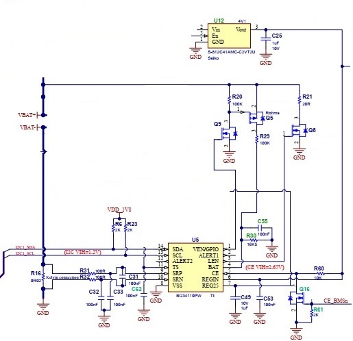

    Maybe something is wrong with our design or timing. If it can help here is the electrical schematic:
  • Hi Jerome,
    Thank you for the detailed post. Will need to discuss this information internally with more team members as we try to root cause this issue.
    With respect to the schematic, nothing sticks out offhand. How heavily loaded is REG25? I see a line disappearing off from it. The connection to the TS pin is also missing in that portion of the schematic. Assuming the thermistor is there, but can't see it.

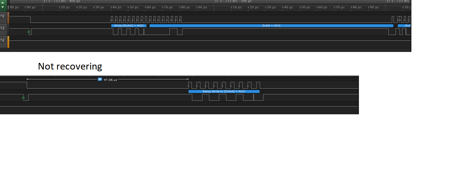

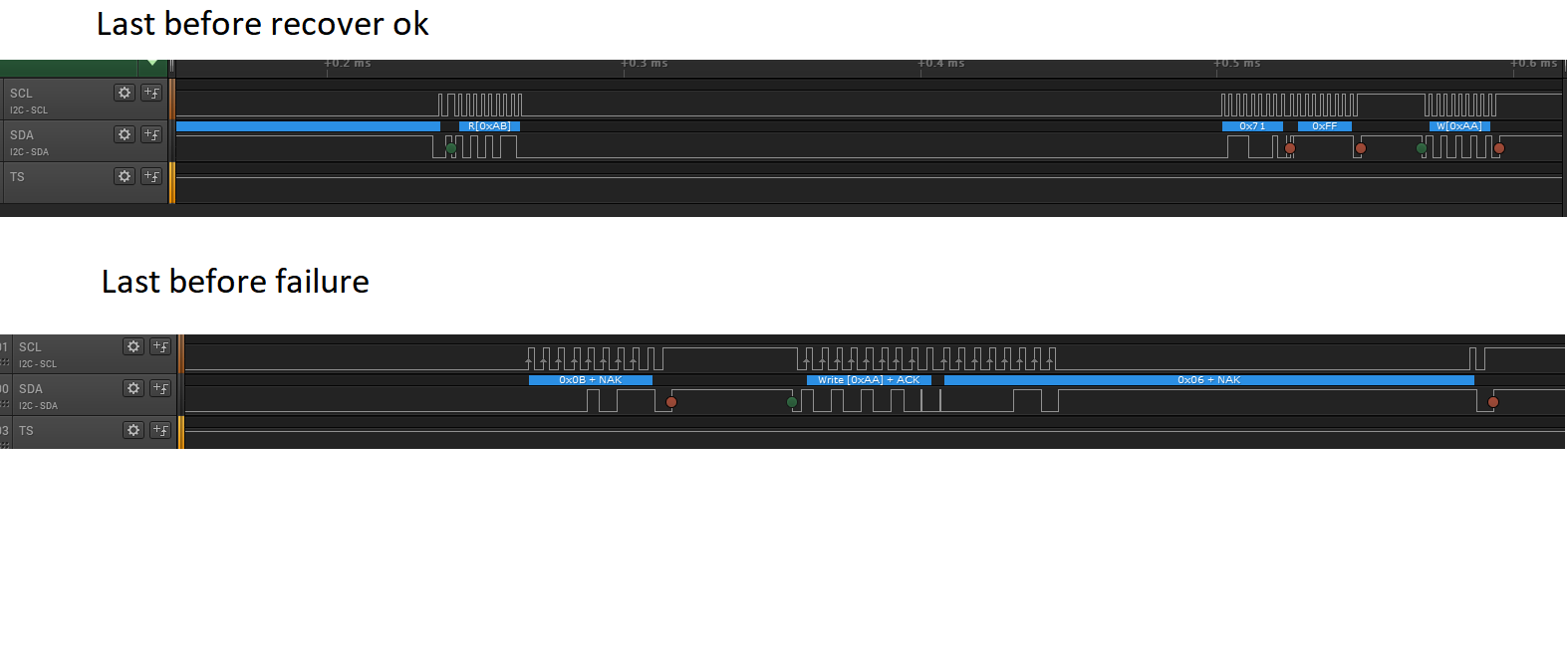

  • I did zoom in to compare the first exchange when it did succeed and when it did not, I have a feeling like something is wrong in what the mcu expect at that point versus what the BQ is expecting. First message after recovery:
    And the last message before the problem:
    We have good news around the 80ms delay and 500ms between access. We had a few units running since yesterday with a new firmware and we had the chances to see cases of access that took longer than 10ms and the unit behaved properly. We are running more tests to build up the confidence level, but so far, with modified firmware delay + extra tracking we have an I2C that looks good.
