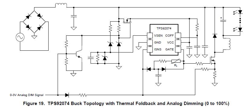

TPS92074: Is Analog Dimming possible from 0% - 100%
Part Number: TPS92074
Dear TI,
Referring to the data sheet  of the TPS92074 (SLUSBO7-Aug 2013) I have a question regarding the schematic in Figure 19. I would like to dim the light of the LED-string from 0% gradually up to 100%. But looking at the schematic I doubt if this is possible considering the diode and transistor in the input circuit. Also there is no description of operation referring to this figure. Could you give me some more insight in this?
Frits
