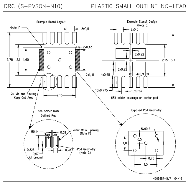

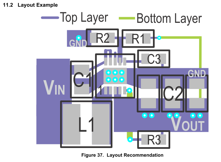

Hi Experts,
The recommendation footprint of TPS61230 is shown below.
There are two keepout area. Is this area should keep out all trace ?
The Layout example seems not do so.
