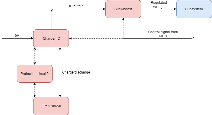

  • Hi Jeff,
    This is the current architecture that I have in mind. In the incident where the main power from 5V rail is cutoff, the charging circuit will change to supply power to the subsystem by the 18650s.
    When the UPS is active, it will only provide power to the subsystem but not the whole system, so the 5V rail that charges the battery will not be powered.
    The power rails available are 5V and 12V, charge current for the 18650s can be low, around 1A?
    The power consumption of the subsystem will not exceed 10W, so I would like to spec the charger IC to be around 12W.
    The MCU in the subsystem will need to be able to turn off either the regulator, or the charging IC, to differentiate the difference between a normal shutdown of the whole system, or a power issue that causes the 5V rail to be cutoff.
  • Hi CC,
    The BQ25606 is my recommendation for the charging circuit. When powered from 5V, it will provide power to its SYS output (IC output above) with a minimum system voltage of ~3.7V and then starts following the battery voltage up to BATREG. The SYS output always has priority over the BAT output. It has a /CE pin to turn battery charging on and off. Once 5V is removed, the battery at BAT connects to SYS through the internal BATFET and powers the system.
    For the buck/boost, I recommend TI's TPS63000 family. For the protection circuit, I recommend TI's BQ2970 family. For questions on those ICs, please submit new e2e forum posts.
  • Hi Jeff,
    What I am looking for is to turn off SYS output in the circuit, as I am trying to stop the UPS from supplying power to the subsystem when the whole system goes through a proper shutdown process and cutoff the power rail, instead of a power issue that cause the power rail to be cutoff.
    Thank you for your suggestion on the other 2 TI device.
  • Ok. Try BQ24250 which has ENx pins that can be used to put the charger into HiZ which turns off the buck converter and connects BAT to SYS. If you need to also disconnect BAT from SYS (ship mode), I recommend BQ25896 which requires I2C communication for entering HiZ and ship mode.
