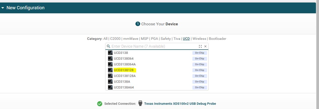

I am trying to flash the UCD3138A64Q through UniFlash v4.6.0.21 using the XDS100v2. I use it in older projects flashing the UCD3138A64 (Without the Q) and I had no problems.
My first doubt is about what target configure, from my understanding I have to select the UCD3138A128, right?
Then I am able to read the memory, so it means the connection between XDS100v2 and the UCD is working:
 Then, when I try to load the image I have the following error:

Do you have any idea what is happening? Please finde attached the UnitFlash Session saved

    I have tried on a UCD3138128 (I don't have a UCD3138A64A but they should be exactly the same) using your session settings, on Uniflash 4.6.0, but with a different x0 file (I'm using the lab 1 code compiled for the UCD3138128), and it is working okay for me.
    One strange thing I noticed is that Uniflash seems to be trying to write to RAM - see below - address 0x6A048 is in RAM.
    Do you have a code that executes from RAM but is stored in program flash?
    I'm not sure what is going on here. Let me talk to some folk in Dallas and get back to you.
