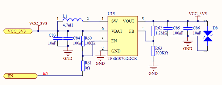

I am using TPS61070 as below, Io=100mA. Could you please help review the schematic if we have any risk on below application?
BTW, I cannot find the minimum on time of our device, could you please help provide this spec? Thanks.

Hi Charles:
I'm sorry that I have no data of min Ton in hand. I'll check with my team.
For the circuit:
1. How does the system Pull Up/ Down the EN? Does customer care about the power loss when the socket disable?
2. Does it startup with 100mA load? If it does, the startup may fail.
