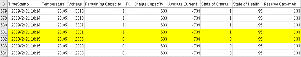

Hi TI support members.
I measeured the relationship between Resaeve Capacity, Remaining Capacity and Terminate Voltage (Refer to attachde file).
I tought the relationship are as the table 1.
But following mesurement result weren't as I thought (Terminate voltage and RC = 0% are the same point).
Please tell me if there is something wrong with my thinking.

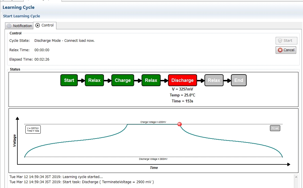

  • Hi, Onyx -san,
    In your comment  at Feb,28th :
    > Do you have qmax and resistances updated in your test to indicate the gauge has learned Ra and qmax properly?
    Could you please let me know how to learned Ra and qmax properly?
    He use Learning cycle in bqStudio as below and use the battery which voltage is 3257mV. Once push the start in GUI, the learning start from Discharging as below. Could you please check the procedure to run learning?
    - Should use use fully-charged battery?
    - How much time should user wait for Relax -> Charge -> Relax -> Discharge -> Relax ?
    (I cannot find the document how to learn the battery.)
    Nagata.
  • hi Nagata
    Use the attached slide to guide the customer learning cycle
    0246.LearningCycleOverview_bq274xx.pdf

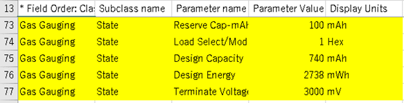

  • Hi, Onyx -san,
    Below is Chiaki -san setting for reserve capacity:
    Unfortunately, the gauge report Remaining Capacity = 0 at Terminate voltage with above setting.
    Is his setting correct?
    Nagata.

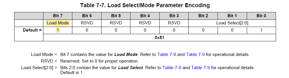

  • pls change load mode to 0 and retry your test.
    thanks
    Onyx
  • Hi, Onyx -san,
    The Load mode is already 0. The Load Mode bit is located at bit 7 in Load Select / mode register.
    This meaning of his setting "1"  is Load Mode = 0, Load Select =1.
    Nagata.
  • Hi Nagata
    Setting the load mode to 0, sets the gauge in constant current mode.
    thanks
    Onyx
  • Is your meaning that the load mode  load select register should be 0?
    Nagata.
  • Why does user not use the reserve capacity with load select = 1 when Load Mode = 0?
    Nagata
  • Nagata
    Their units are no the same. You need reserve capacity in  mAh for load select 0 which is constant current.
    thanks
