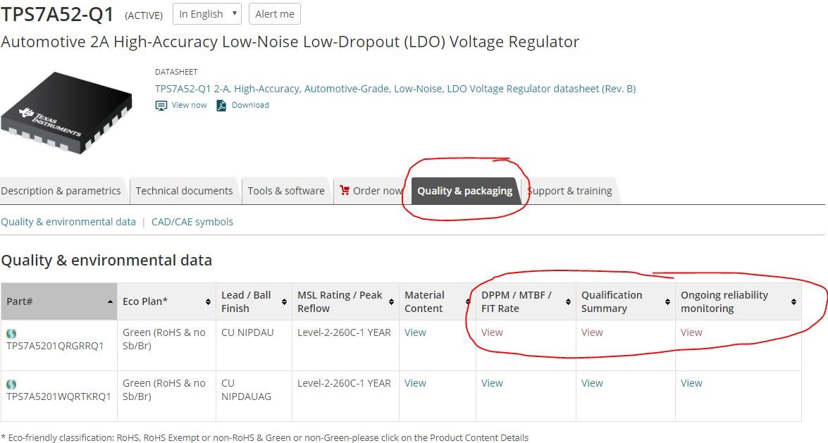

  • Hi Nerea,
    Our publicly available reliability results are actually located at the Reliability Homepage that I sent you in my previous response.  You would simply need to type in your part number(s) if accessing the results through that method.
    A potentially quicker way to access the same information is to go though the Quality & packaging tab of your intended part's product folder:
    Very Respectfully,
    Ryan
