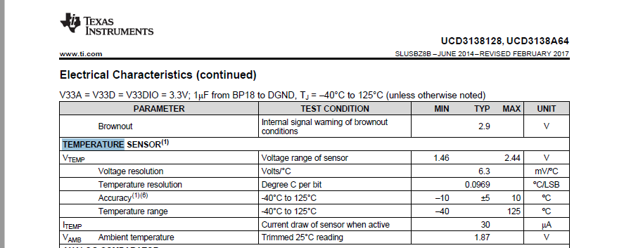

I are trying to access the internal temperature sensor of UCD3138A64  at channel 15 on ADC12 but we are not sure the training labs provide us with the adequate code we need for accessing the same. I need help with the programming of the internal temperature sensor. I have searched all the training videos and the datasheet too. It would be great if you could guide us about the same.

  • .We correctly configured the registers as per mentioned.The temperature sensor result is checked on the ADCRESULT0 register at the memory location 0014001C , C51 was the value displayed at the ADCRESULT0
    register
    As per the given data, the temperature value C51 corresponds to 2.5mv which is out of range of the given voltage range of the sensor. So, this proves that the result calculated is incorrect. How to correctly configure and calibrate the temperature sensor?
