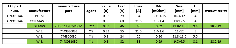

We need your urgent help about below
1)Today we use PULSE and COILMASTER chokes -120A-for 6 phase-20A to 1 phase.
We think to use new chokes with better res. and current.
Marking in green below-height around 9.4 mm
Could you check if we can increase current per phase to 30 A by using new chokes?
 2)
If we work with same design, with 3 X TPS40140
And want to work only with 5 phase
e.g. one phase of 6-will be not in use.
Do you see any problem with it?
