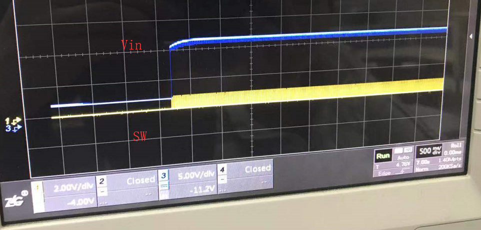

When I test the load capacity of the device, there is a question about it, as below, my design is according to EVM, Vout set 5V.
1. When my load is 1.4A, then Vin power on, but there is not any output, Why ? the below waveform is SW and Vin pins(blue is Vin, yellow is SW)
2. When Vin power on, then put on my load 1.4A, the device is normal , the output could be 5V.
3. When my load is below 1.2A, the device is normal, the output could be 5V.

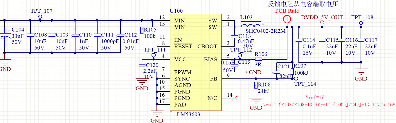

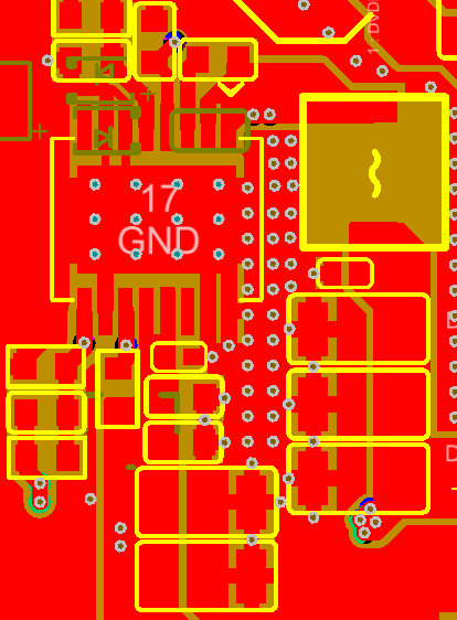

  • Dear Tim
    Thanks a lot. Below is my sch and PCB, please check it.

  • Went,
    Note that if an electronic load is connected to the output, it may draw a transient current pulse during startup that may engage current limit. Can you zoom in to see the SW node waveform, Vin and Vout (e.g. 2us/div). Also, I recommend probing the inductor current.

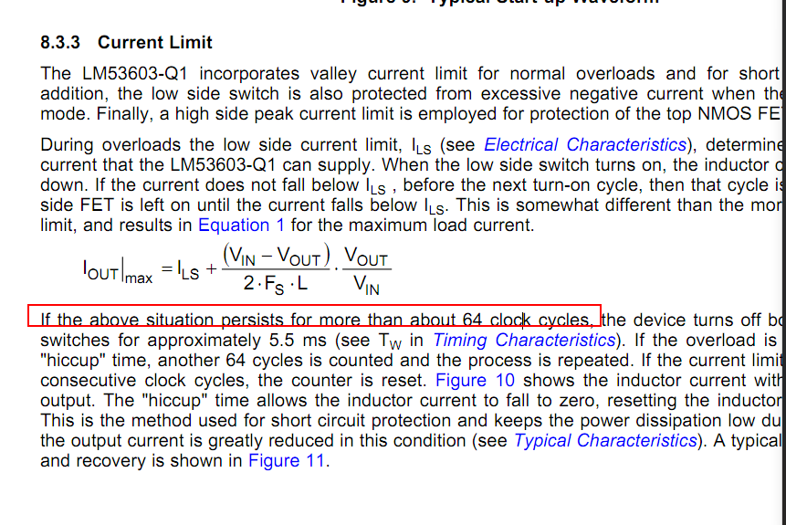

    3. In the datasheet, as below picture, Fs=2.1MHz,64 clock,64*1/2.1M = 30us,that means the time of overcurrent more than 30us, the device cann't start ?
  • Hello Went,
    Tim has asked me to help since I am more familiar with this device.
    It is true that if the part is run in current limit for more than 30 – 60 us, the part will repeatedly try to restart. The reason that the time I list is longer than your calculation is that typically frequency is reduced in current limit. If the part is running in current limit, the part should repeatedly try to restart, see figure 10 and 11 in the datasheet. Also note that the 30-60 us current limit duration starts after the preprogrammed soft start time, TSS in the EC table, during each startup attempt. If the part is not trying to restart, something else is happening.
