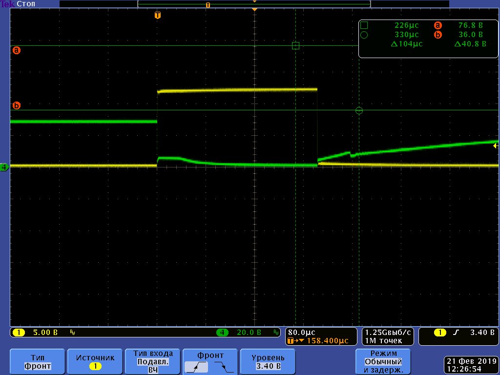

i've made a design with UCC256304 for the first time and it looks like both gates LO and HO open at the same time. How can it be? Please help!

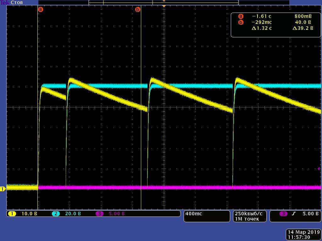

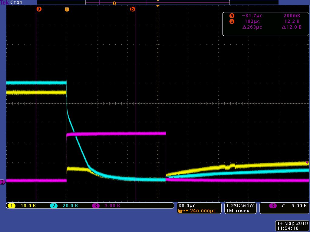

The below are from your message. My question is if the top one is your lower MOSFET Vgs, what is the lower one waveform, and where did you capture your waveform? Based on your reply, the waveform is measured on VT1, so it sounds to me that is Vds of VT1, is it right? Please confirm or clarify which is which and where each did your measure?
No, I’ve measured Vgs and Vds of VT2 in reference to VT2 source, i.e. oscilloscope ground was connected to VT2 source, yellow probe to VT2 gate and green probe to VT2 drain. It surely opens.
I need you to clarify your descriptions. Can you plot VT2 with its Vgs and Vds on a same screen. Based on your previous messages, you described, Vds of VT2 was not low when Vgs was high. That means VT2 did not work correctly and you cannot conclude Vgs of VT1 was on.
So please plot Vgs and Vds of VT2 in the same screen to clarify your description.
