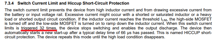

Hi, Team,
Regarding the detection of Current Limit, in the data sheet "When this switch current limits is triggered 32 times, *******"
Is this 32 times in a row? or is it total number of times?
