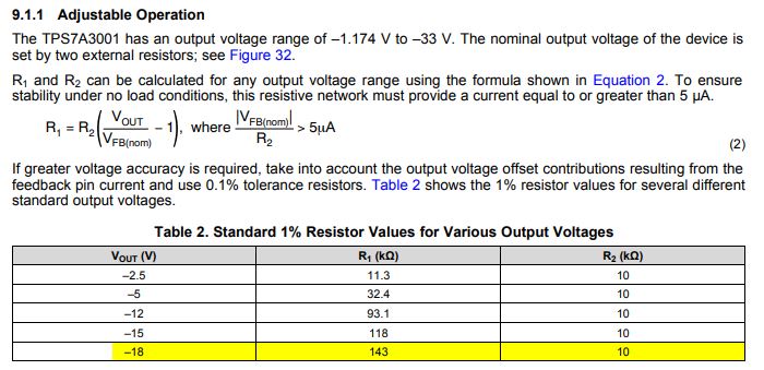

    Both the TPS7A49 and TPS7A30 regulators have feedback networks that operate the same way.  TPS7A30 simply uses negative voltages instead of positive voltages.  As long as we have enough current flowing through the resistor divider (Ifb<<Idivider) we can calculate the output voltage using the following equation:

    You will note that the feedback voltage for TPS7A30 is -1.179 V (typ).  In order to make the feedback pin current negligible, we recommend that the current through the feedback resistors be greater than 5 uA.  This means that the current through R2 should be greater than 5 uA as shown in equation 2.  Once we know R2, we can calculate R1 also shown in equation 2.
    You will note that we give recommendations for a -18 V rail in Table 2.  If we plug in these recommendations, you will note that the output is -18 V:
    Vout = Vfb x [1 + (R1 / R2)]
    Vout = -1.179 V x [1 + (143k / 10k)]
    Vout = -18 V
