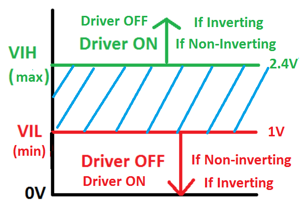

Dear TI team,
Customer want to konw the min value of input signal high threshold.
please help to provide. Thank you!
YIngzhe Xi
  • Hi Yingzhe,
    Thanks for reaching out to the High Power Drivers team, my name is Mamadou Diallo, I am the AE supporting low-side drivers.
    Please refer to the diagram below explaining the functionality of the driver according to the input thresholds.
    Customer may use the values below as reference and approximation ONLY, NOT guarantees:
    VIN_H
    - Output high for non-inverting input pins
    - Output low for inverting input pins
    2V
    2.2V
    2.4V
    VIN_L
    - Output low for non-inverting input pins
    - Output high for inverting input pins
    1V
    1.2V
    1.4V
    Please let us know if you have further questions or press the green button if this addressed your question.
    -Mamadou
