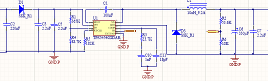

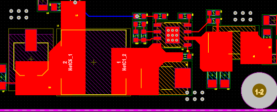

Hi everyone,
I have designed a power control circuit with TPS54540, its input voltage range from 6.5-40V and output current 5A.
I reference the webench circuit to design.
I'm taking 5V when there is no load or supplies 500mA.
However, I have tried over 500mA, the output voltage decreases to around 800mV. (There are no parts which are getting overheating)
Where do I mistake? Please help me.
I enclosed the PCB and schematic.
Disabled the gnd polygon pours for top and bottom.
