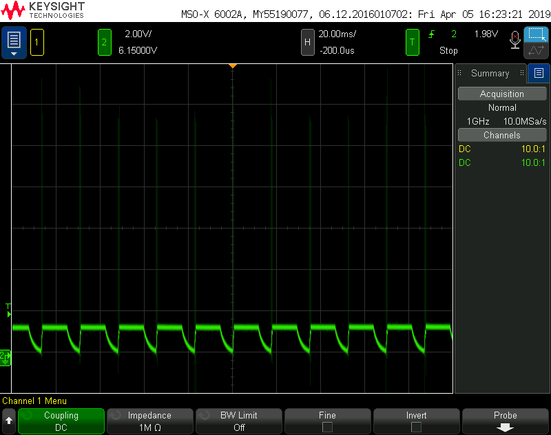

    BUCK6 output in Oscilloscope is as below:

    If you could send me your schematic and layout I would be happy to take a look at it. We at least now know that the cause of the issue is BUCK6 powerfaulting.
    It would also be a good idea to look at a zoomed in scope shot of BUCK 6 with the SW node right before it turns off. Something around the 50uS/div would be good.

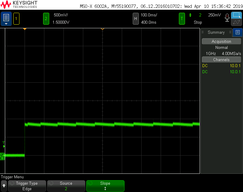

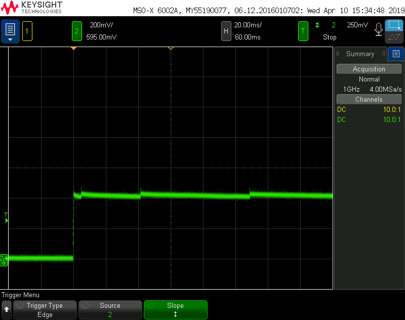

    1) At 50uS/div:
    1
    2) At 20mS/div:
    3) At 50mS/div:
  • Rajneesh,
    I just sent Vikas an email with some feedback on your schematic as well as a document to help calculate component values for BUCKs 1, 2, and 6. Without knowing all of your design requirements I can't recommend exact values, but it looks like your BUCK6 output inductance is too high, and output capacitance is too low.

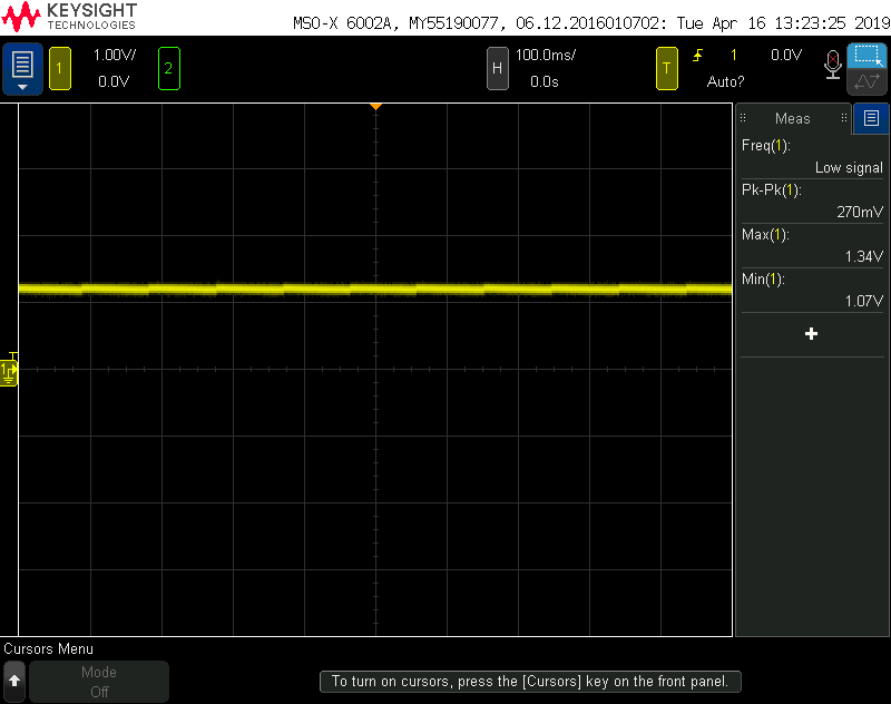

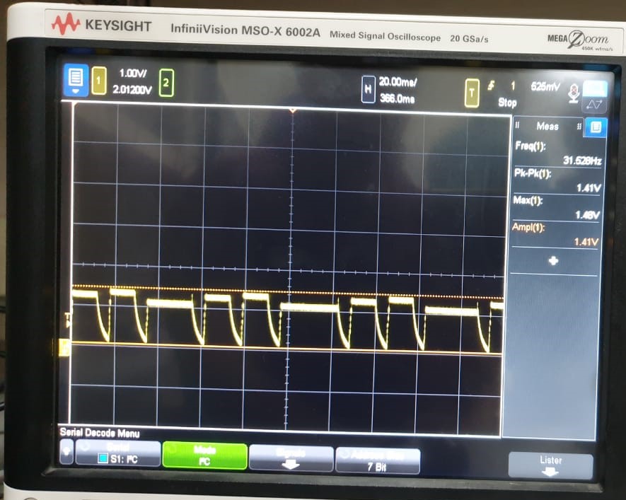

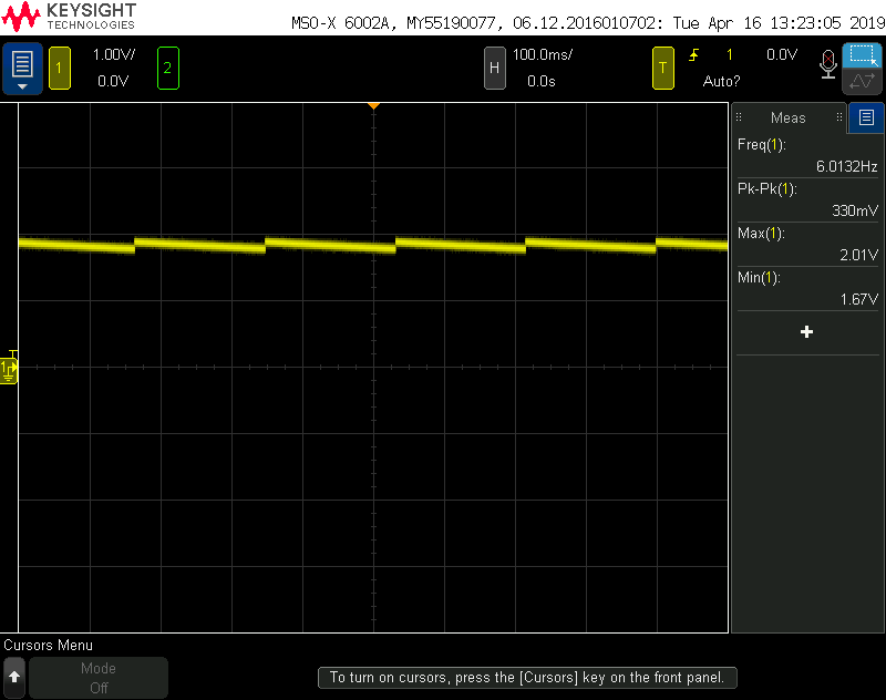

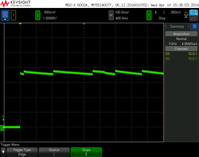

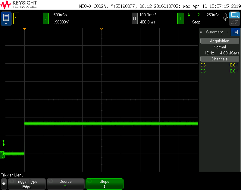

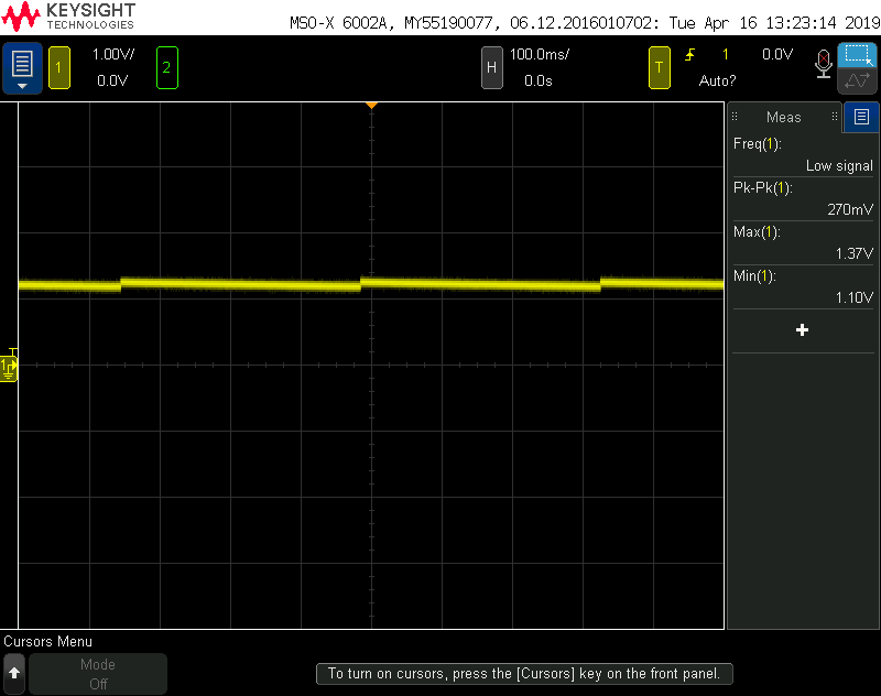

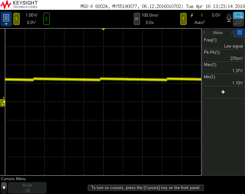

    But output of BUCK1, BUCK5, and BUCK6 are not pure DC, Plz. see below oscilloscope screen capture, there is some dip/pulse is observed. What could be the reason for this:
    BUCK1
    BUCK5
    BUCK6:
  • Rajneesh,
    I am glad that fixed your issue.
    The ripple you are seeing on the output is because the regulators are in auto mode instead of forced PWM mode. In auto mode the regulators will switch from pulse width modulation (PWM) mode to pulse frequency modulation (PFM) mode at light loads. This results in a much higher efficiency at light loads, at the cost of increased ripple and decreased transient performance.
    If you want to switch these to forced PWM mode this can be done using the BUCKx_MODE bits in the BUCK123CTRL and BUCK6CTRL registers.
